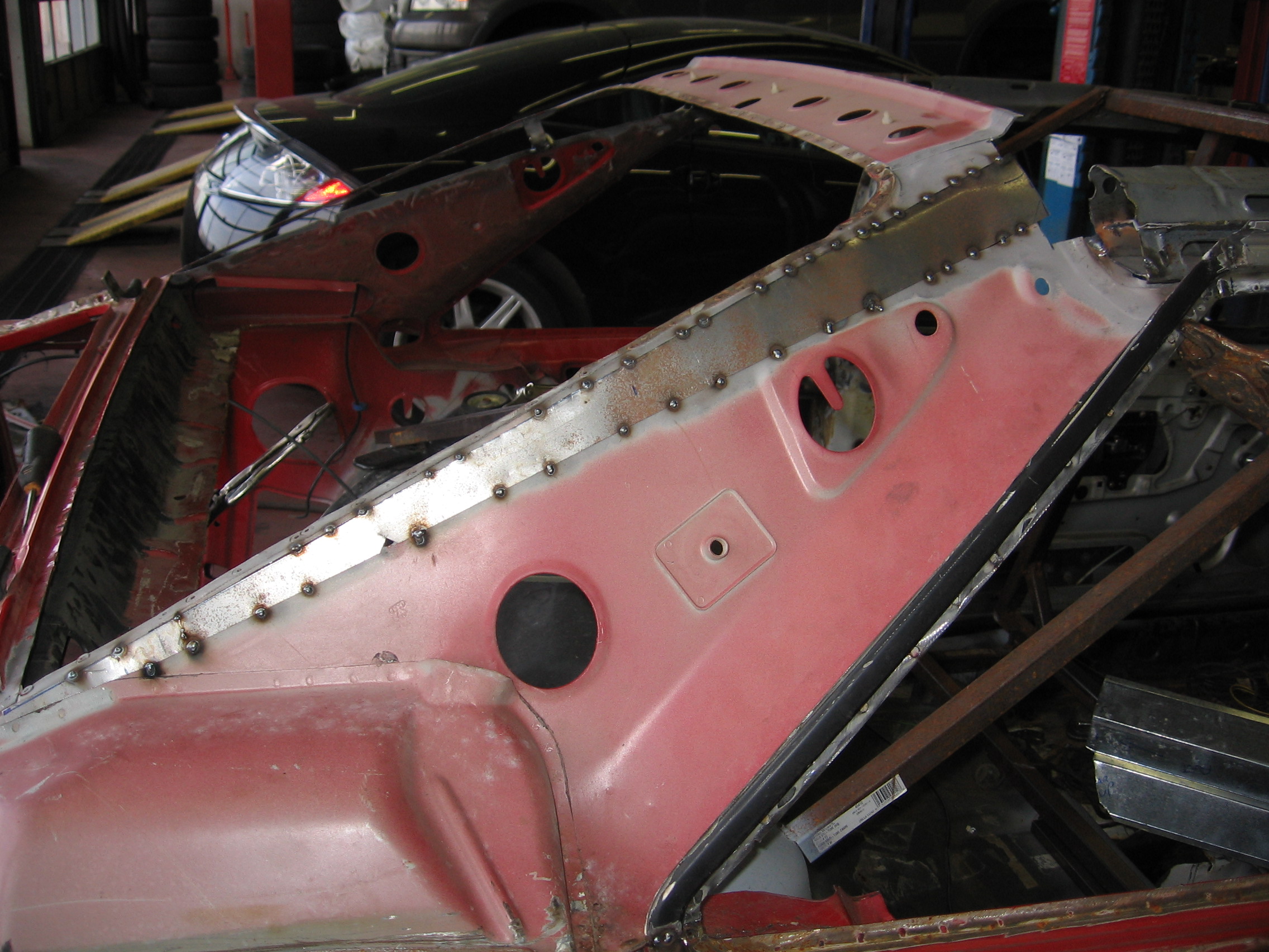

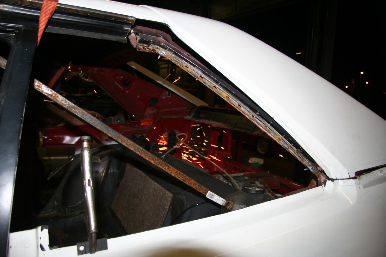

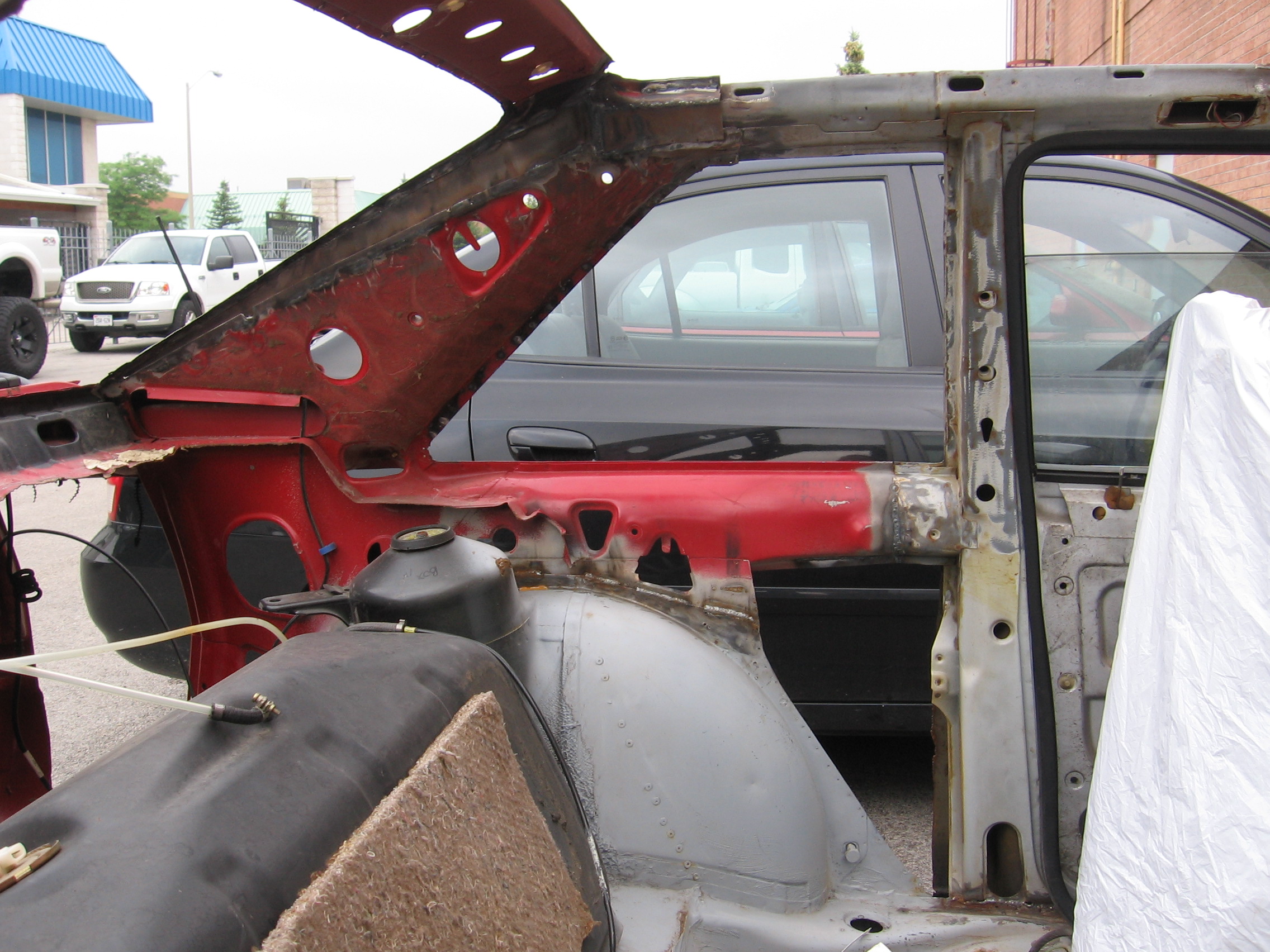

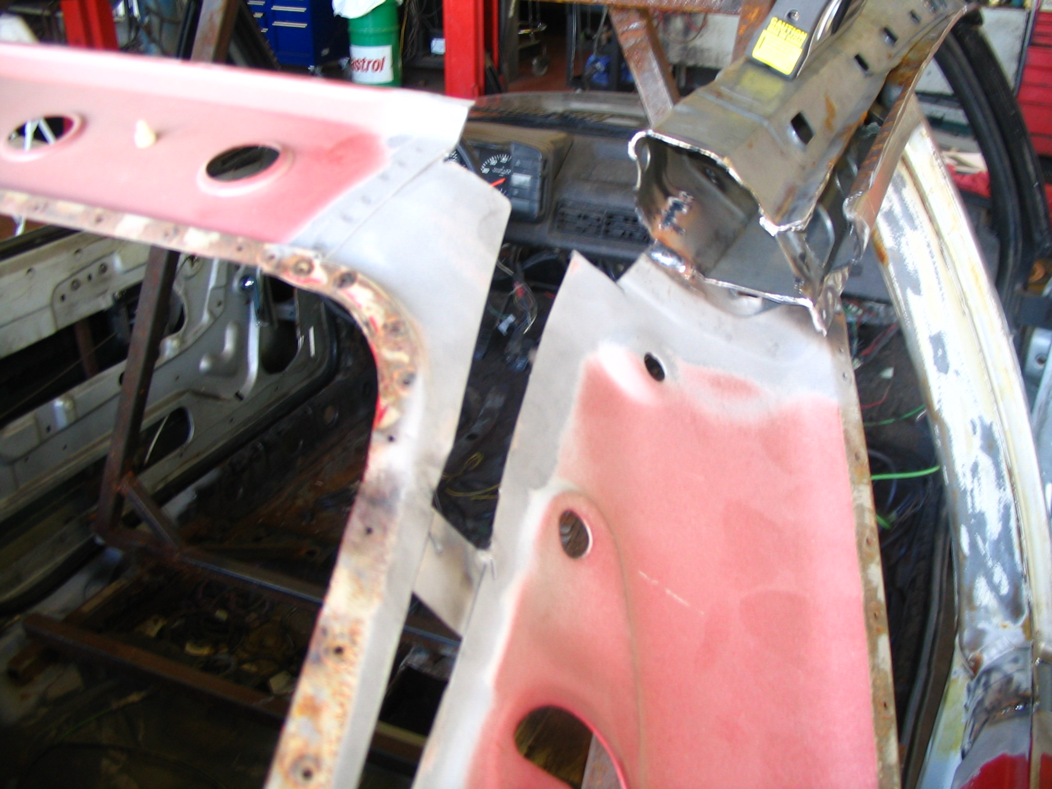

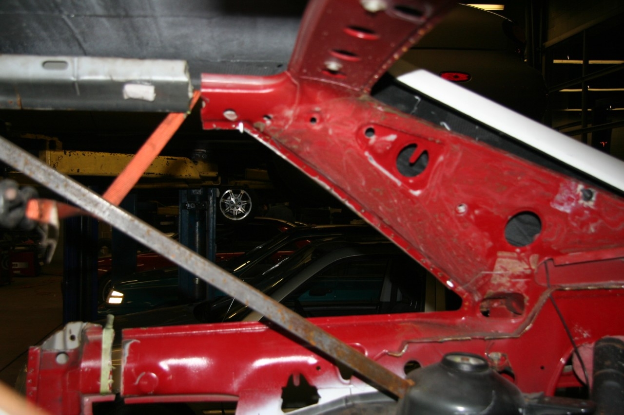

Next on the to do list is modifying the c pillar.
For the people that don't know, the sport quattro C pillar is different than the coupe C pillar.
Both cars use the same rear window,however in the sport quattro the rear window sits at a steeper angle.
So modifications are required.
In these pictures you can see what's required to get the sheet metal to match the Carbon Fibre
sport quattro roof.
Cheers,
Craig Cook.
sport quattro roof.
Cheers,
Craig Cook.
- IMG_5010.JPG (500.38 KiB) Viewed 36305 times
- IMG_4997.JPG (433.53 KiB) Viewed 36305 times
- IMG_4992.JPG (401.88 KiB) Viewed 36305 times

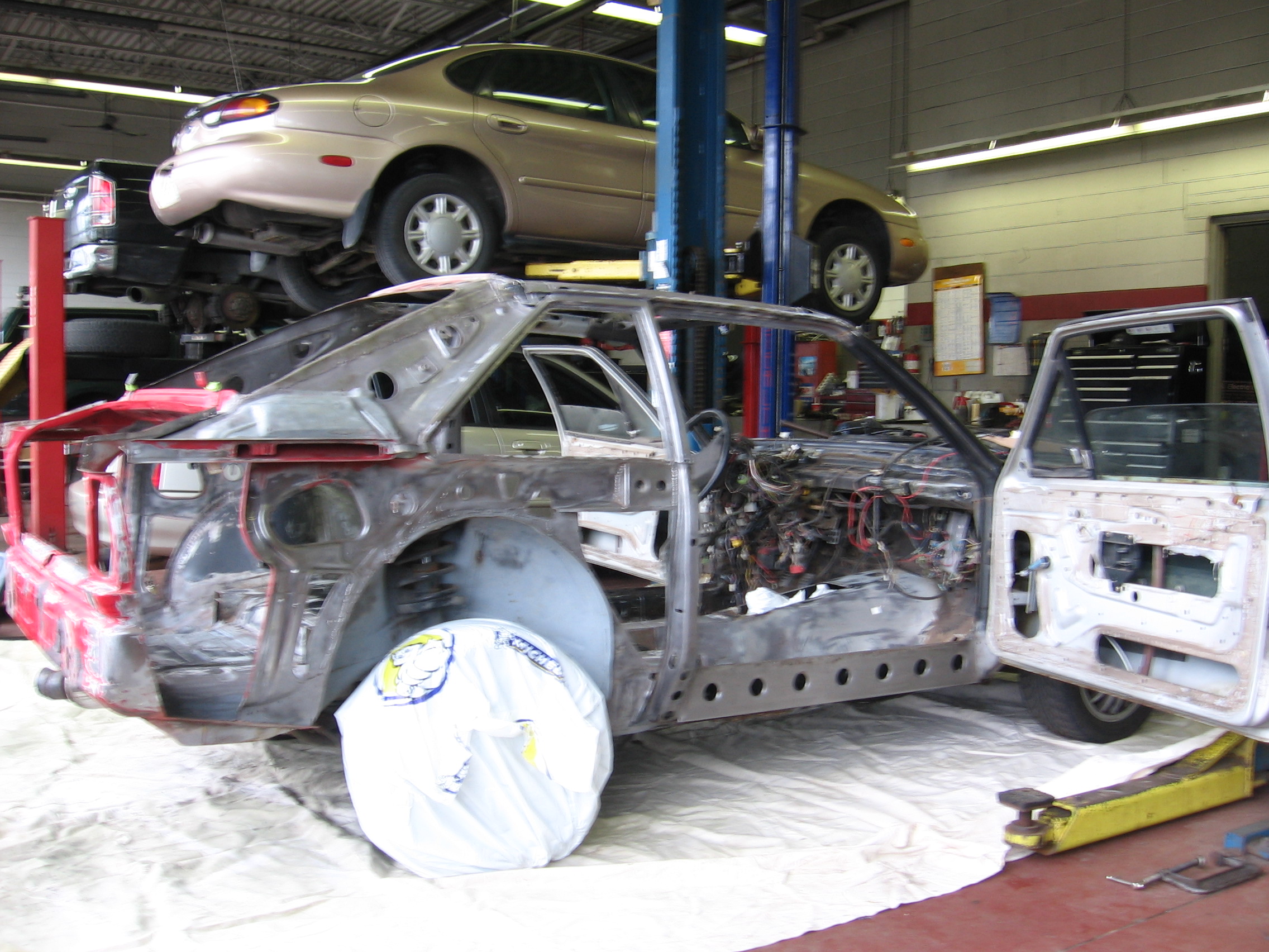

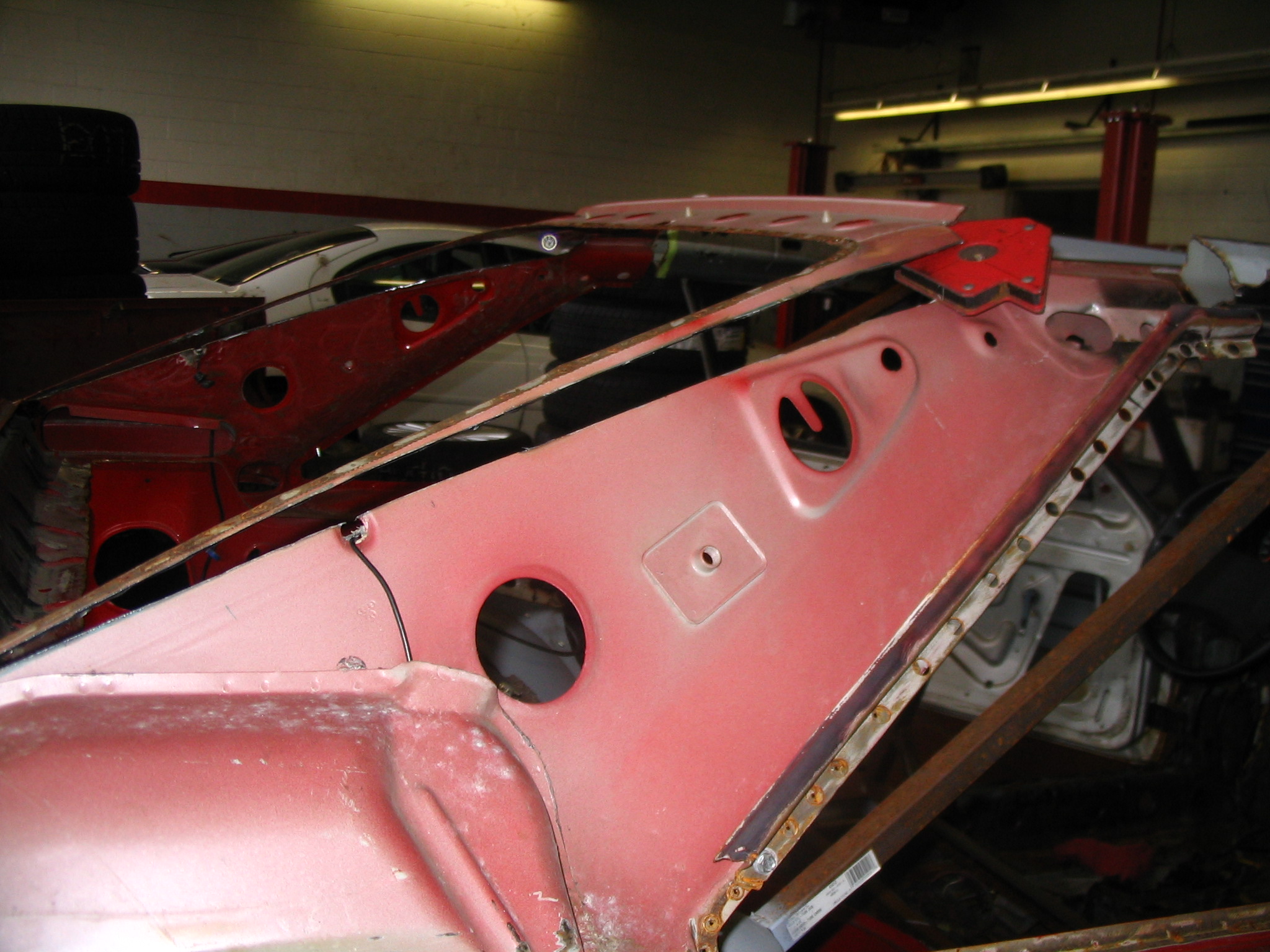

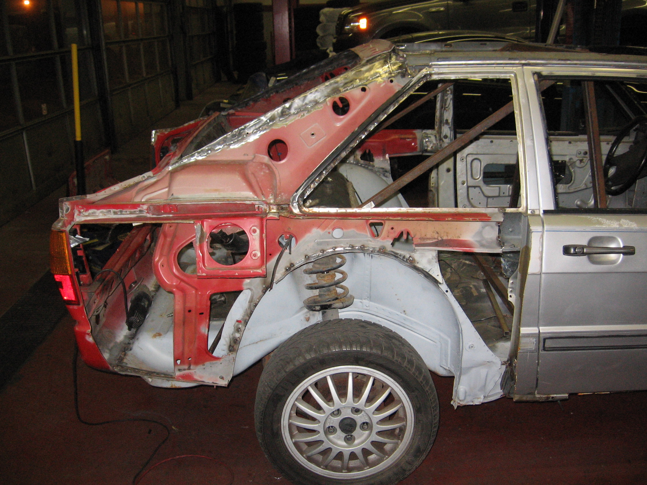

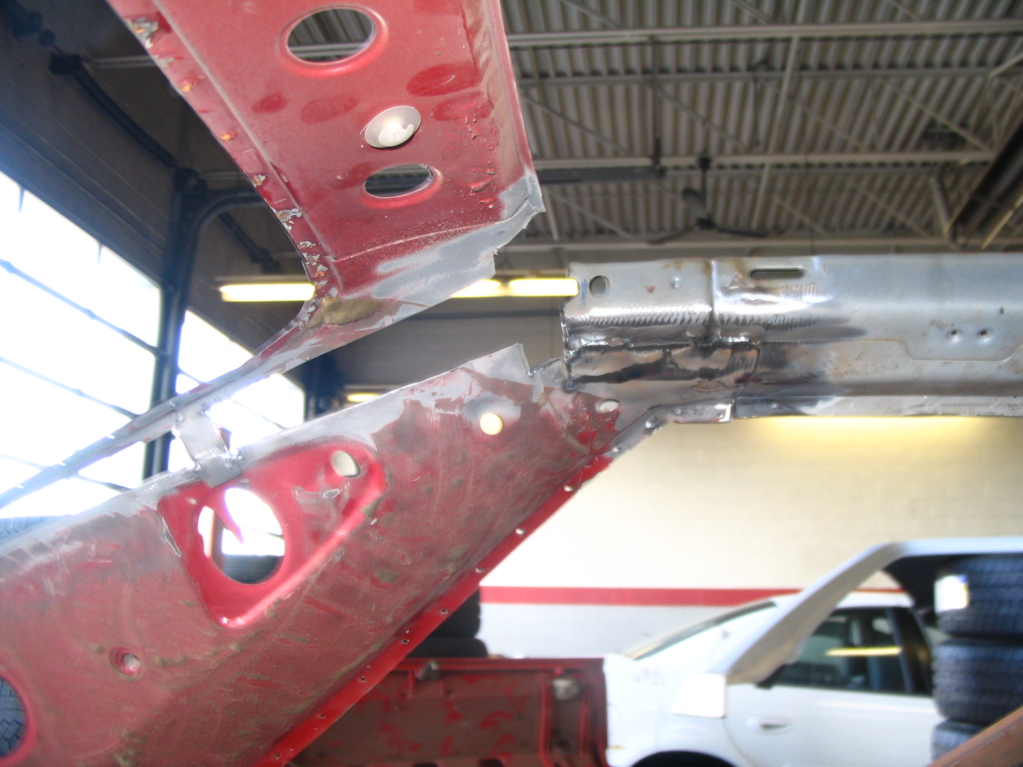

A few pictures of the cutting.
- IMG_1260.JPG (678.4 KiB) Viewed 36305 times
- IMG_1274.JPG (638.88 KiB) Viewed 36305 times
- IMG_1273.JPG (626.24 KiB) Viewed 36305 times
- IMG_1243.JPG (676.89 KiB) Viewed 36305 times
- c pillar modified 002.jpg (891.16 KiB) Viewed 36305 times

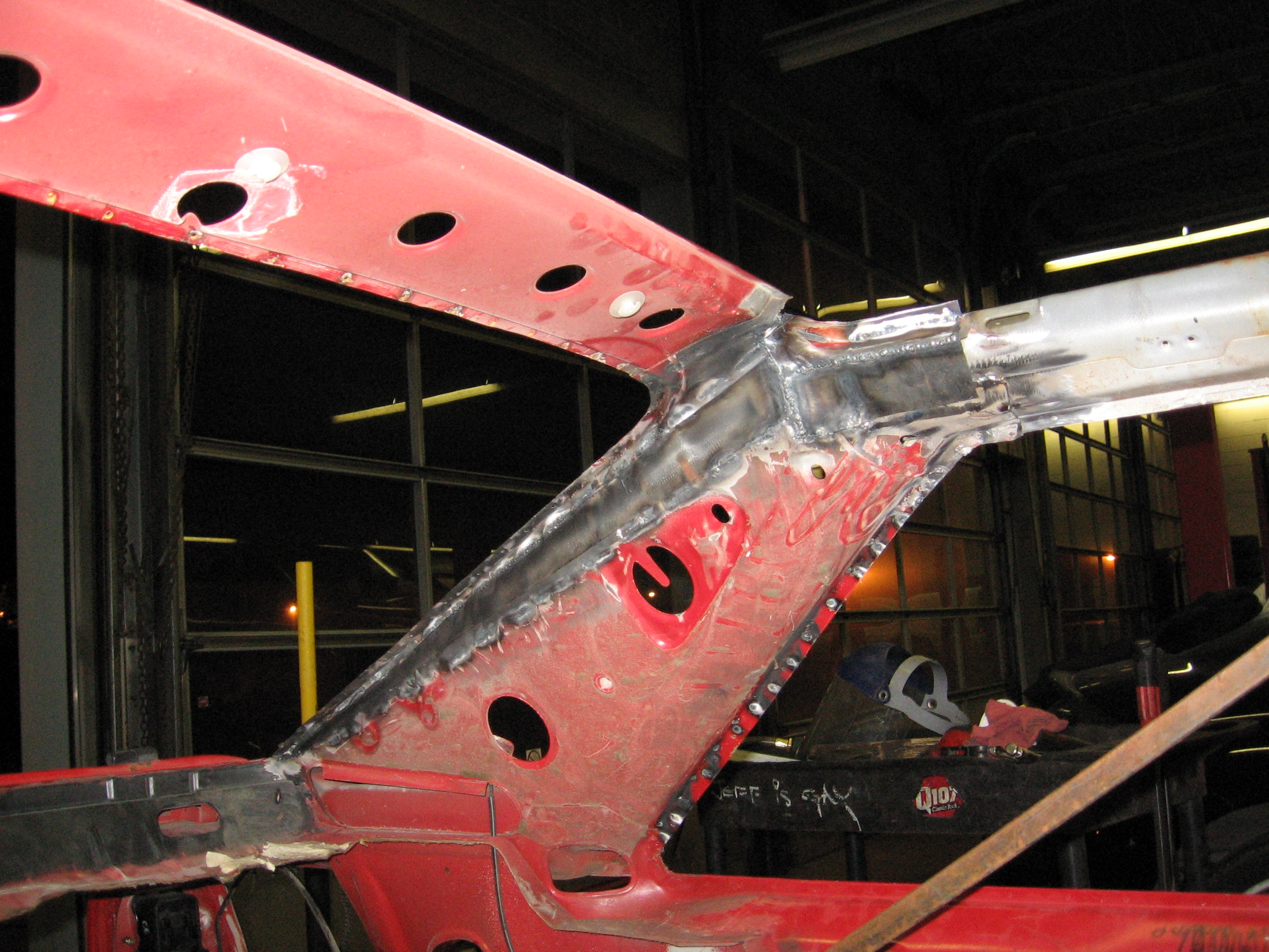

highlander69
- Posts: 279
Re: Craig's Sport quattro build
Still final prep required. Grining welds etc. but you get the idea.
- c pillar modified 003.jpg (1.09 MiB) Viewed 36304 times
- c pillar sport 003.jpg (925.6 KiB) Viewed 36304 times
- c pillar modified 005.jpg (1.12 MiB) Viewed 36304 times

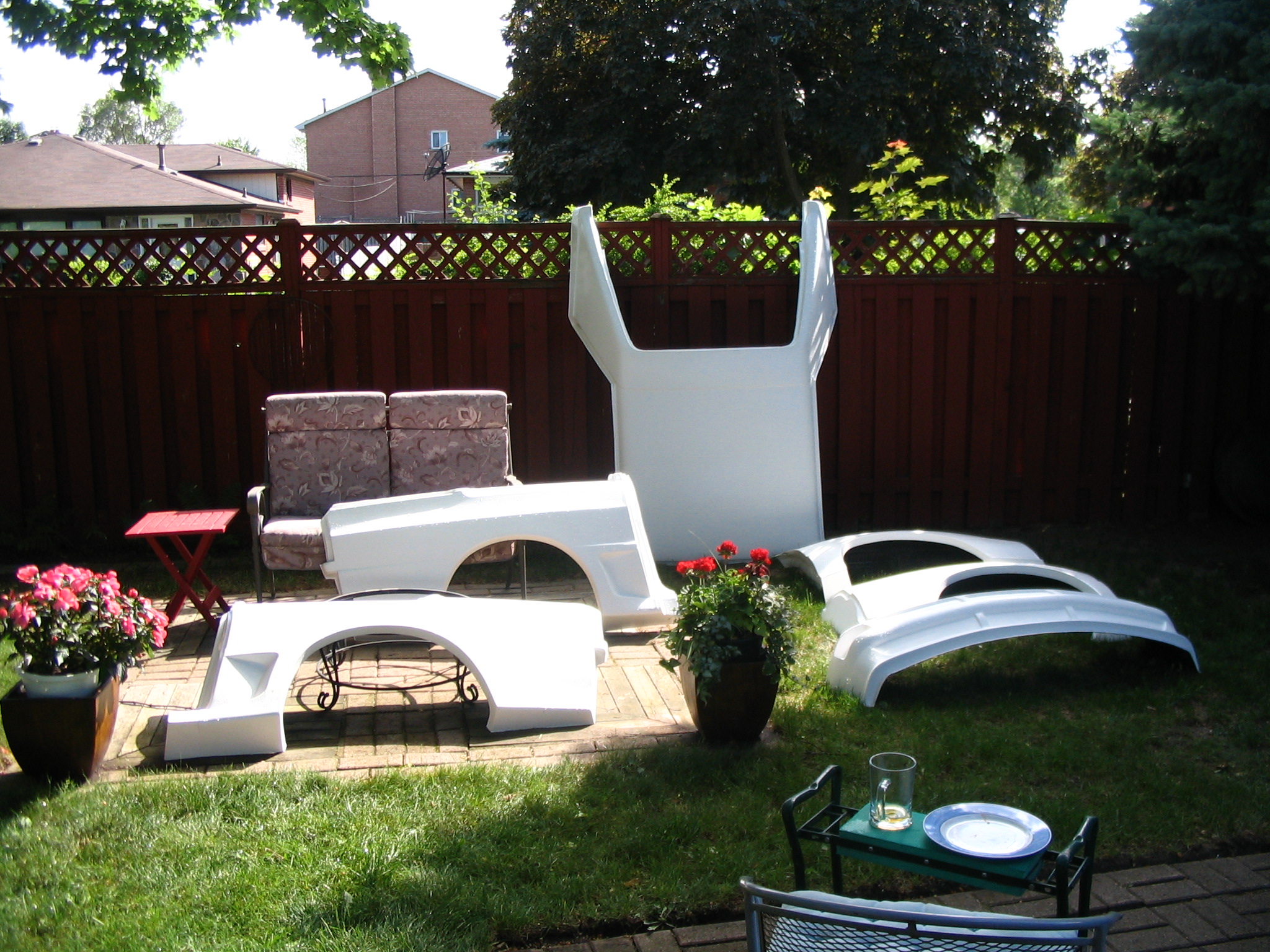

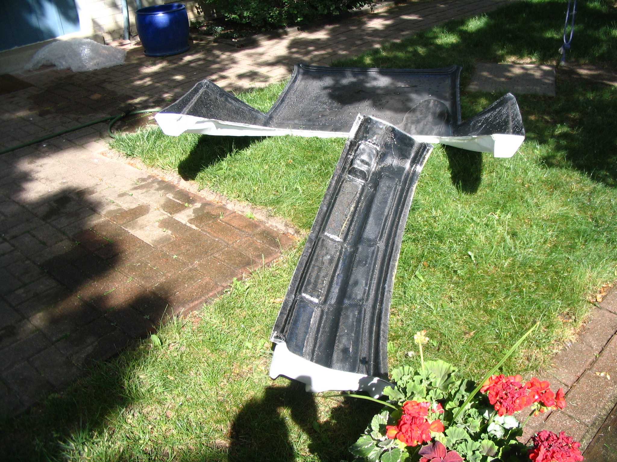

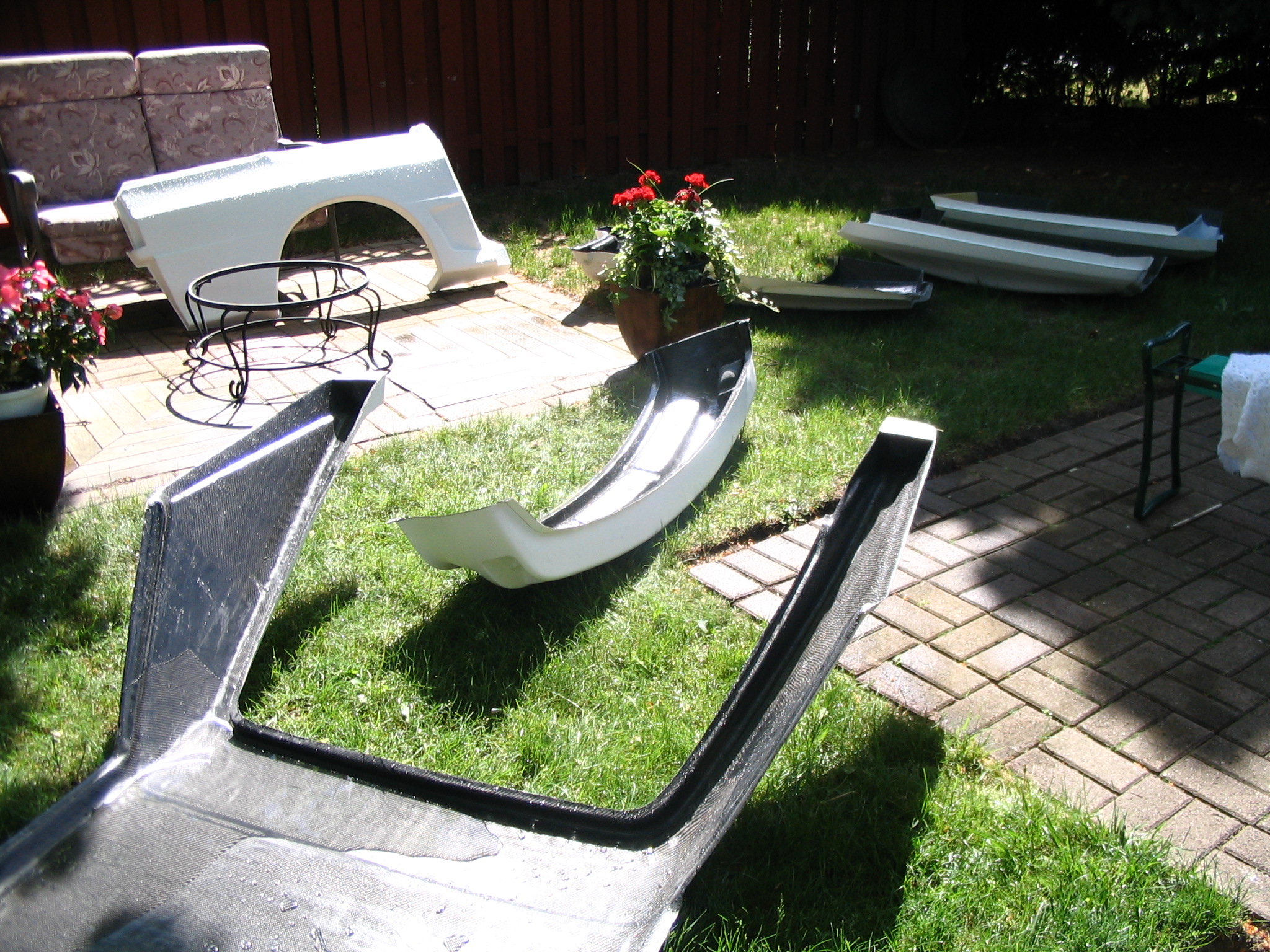

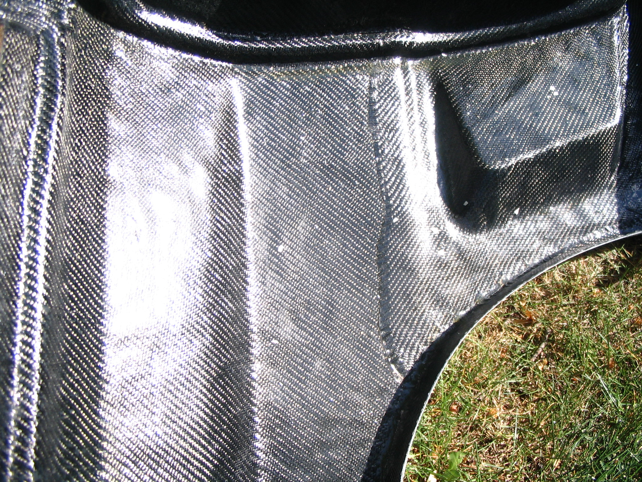

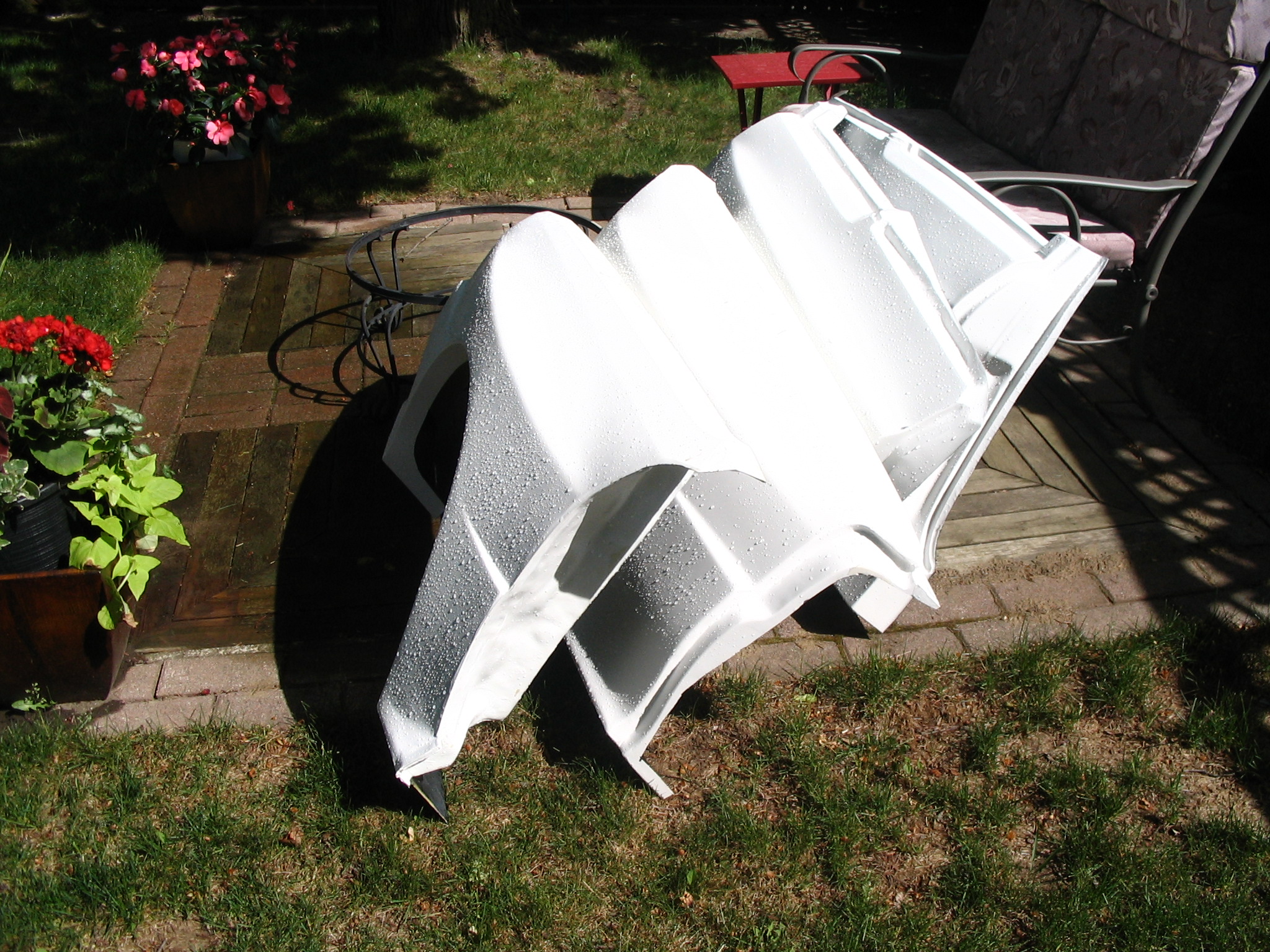

Finally my body kit was done.
I opted for the full Carbon Fibre version.
The hood and front grill still have to be done yet.
I'm really happy with it. Lot's of trimming to do, but I will spend the time
to make sure it fits correctly.

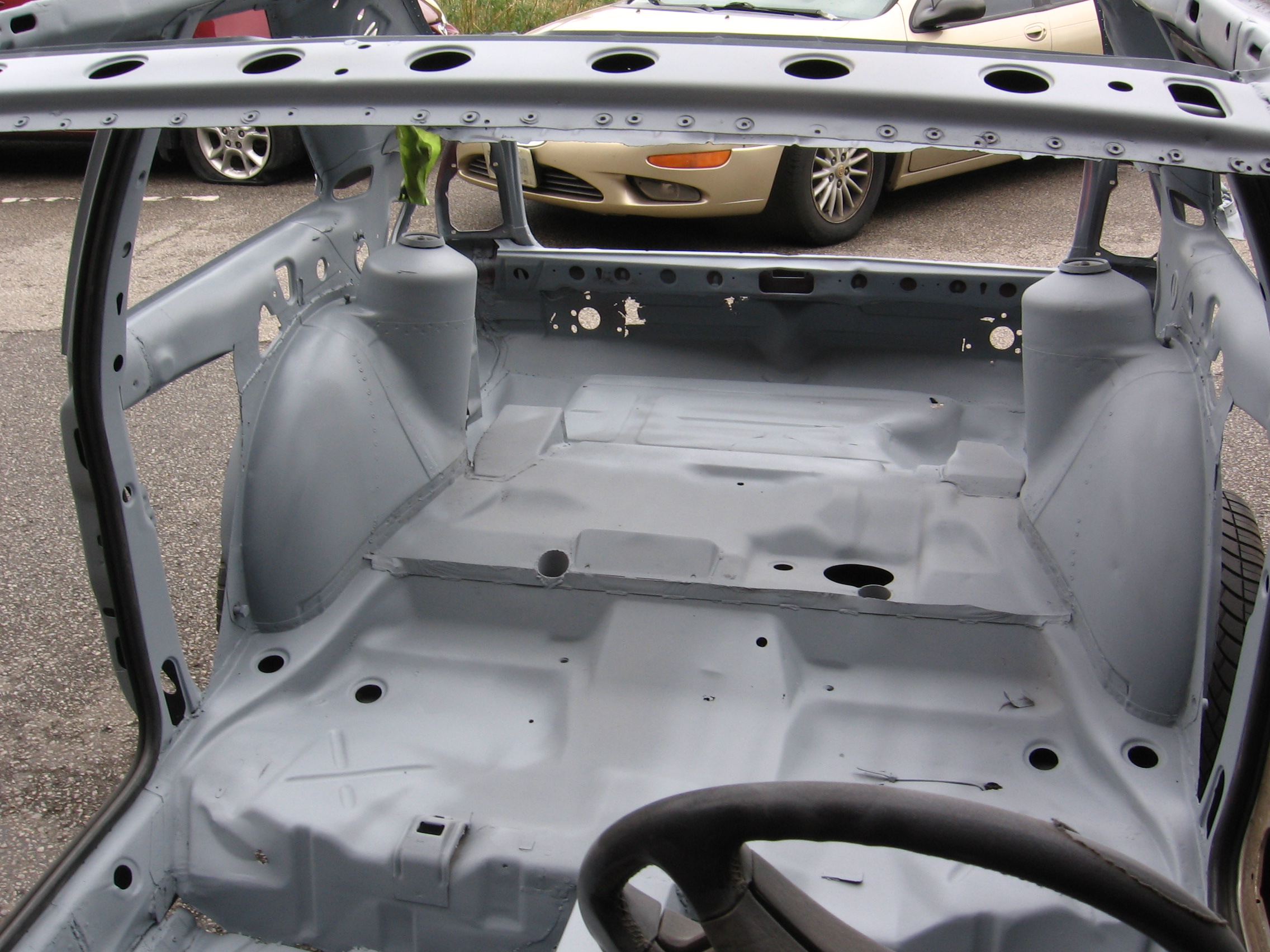

Time to get some primer on this before it goes home for the winter.
- car in primer 001.jpg (958.35 KiB) Viewed 36305 times
- car in primer 002.jpg (887.69 KiB) Viewed 36305 times
- car in primer 003.jpg (864.91 KiB) Viewed 36305 times
- car in primer 004.jpg (784.69 KiB) Viewed 36305 times

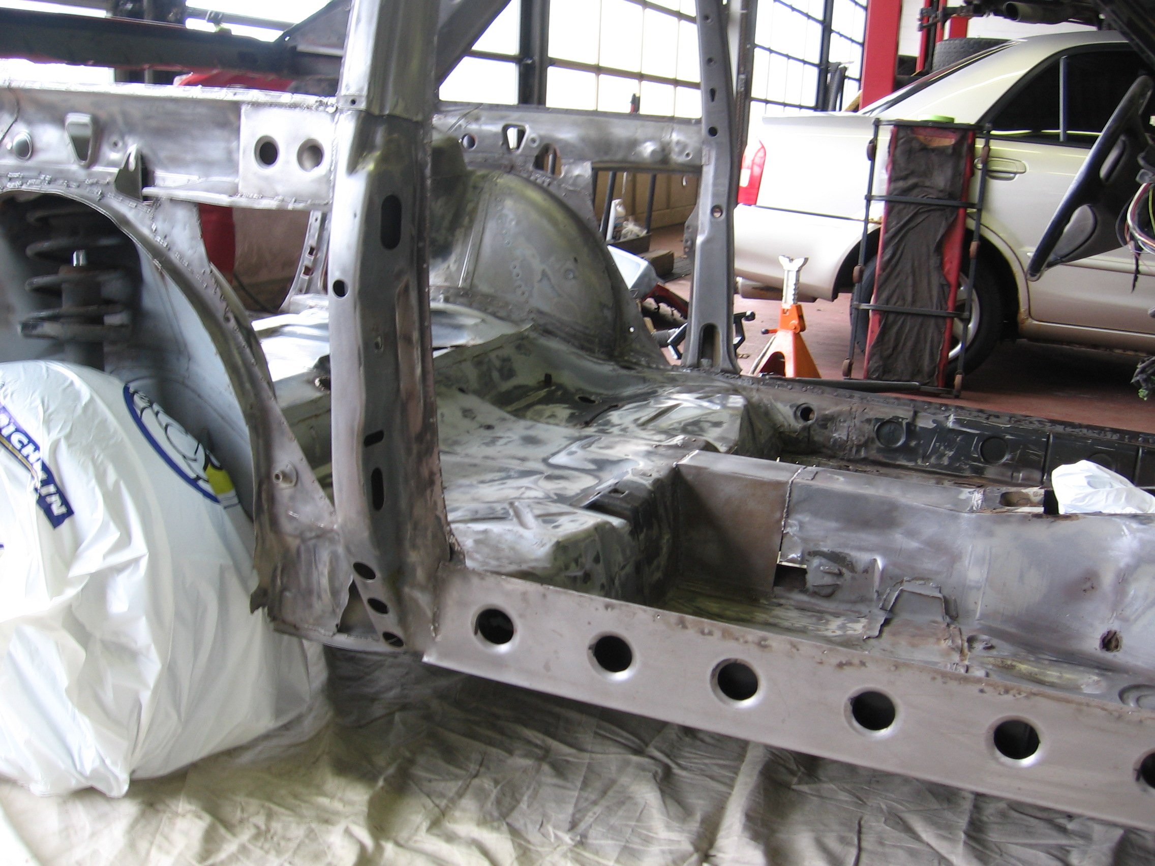

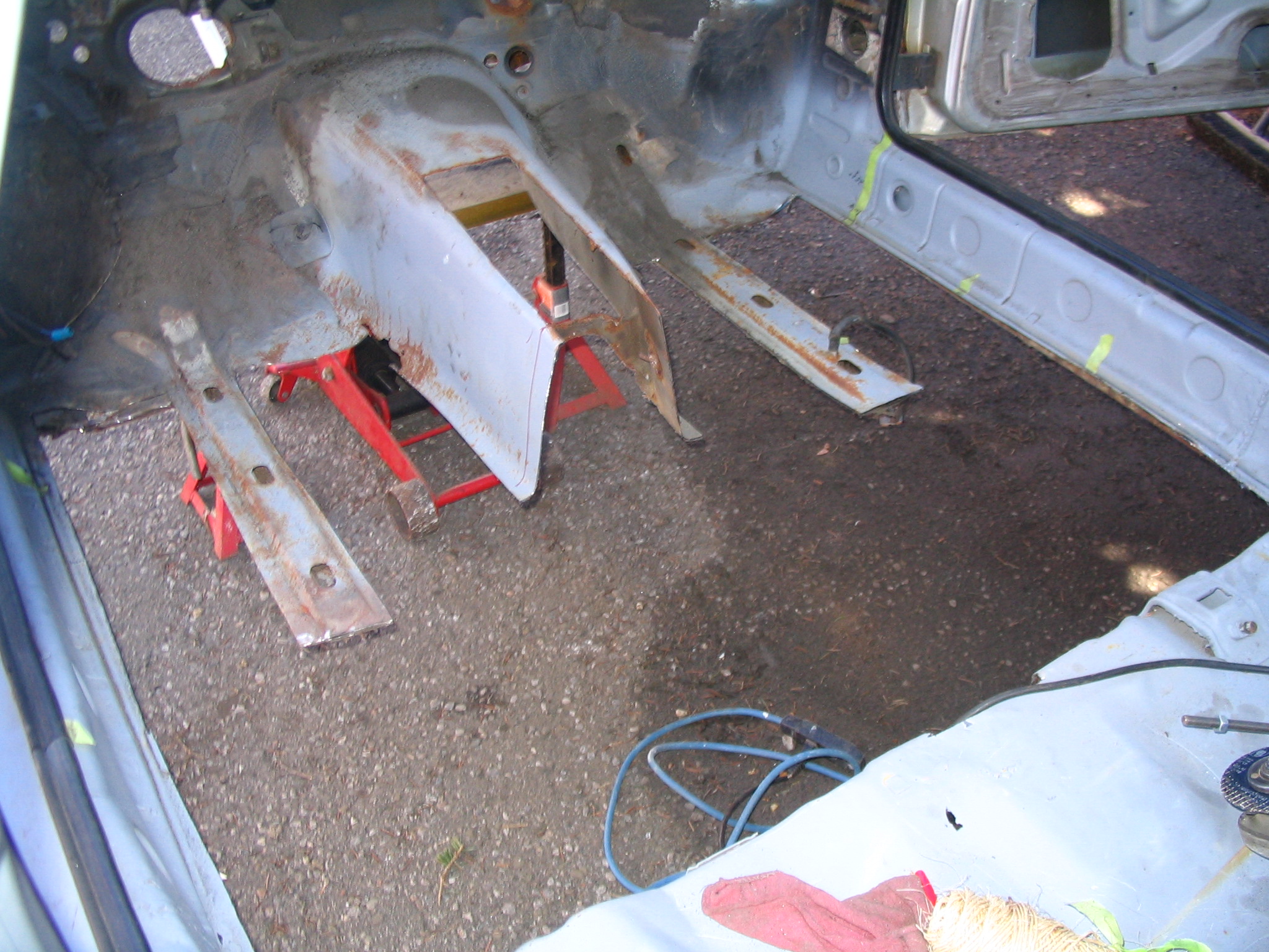

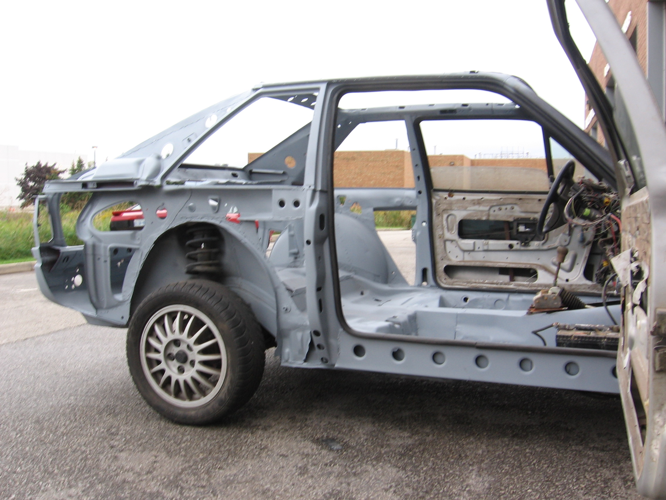

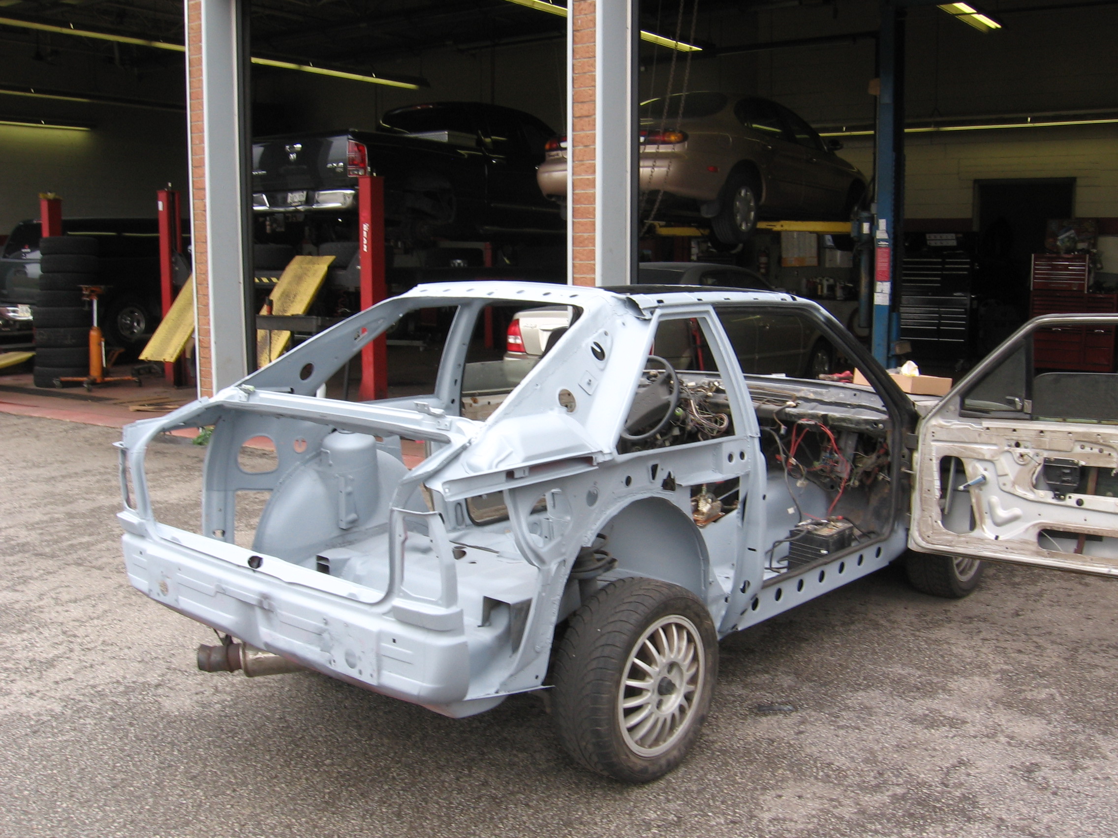

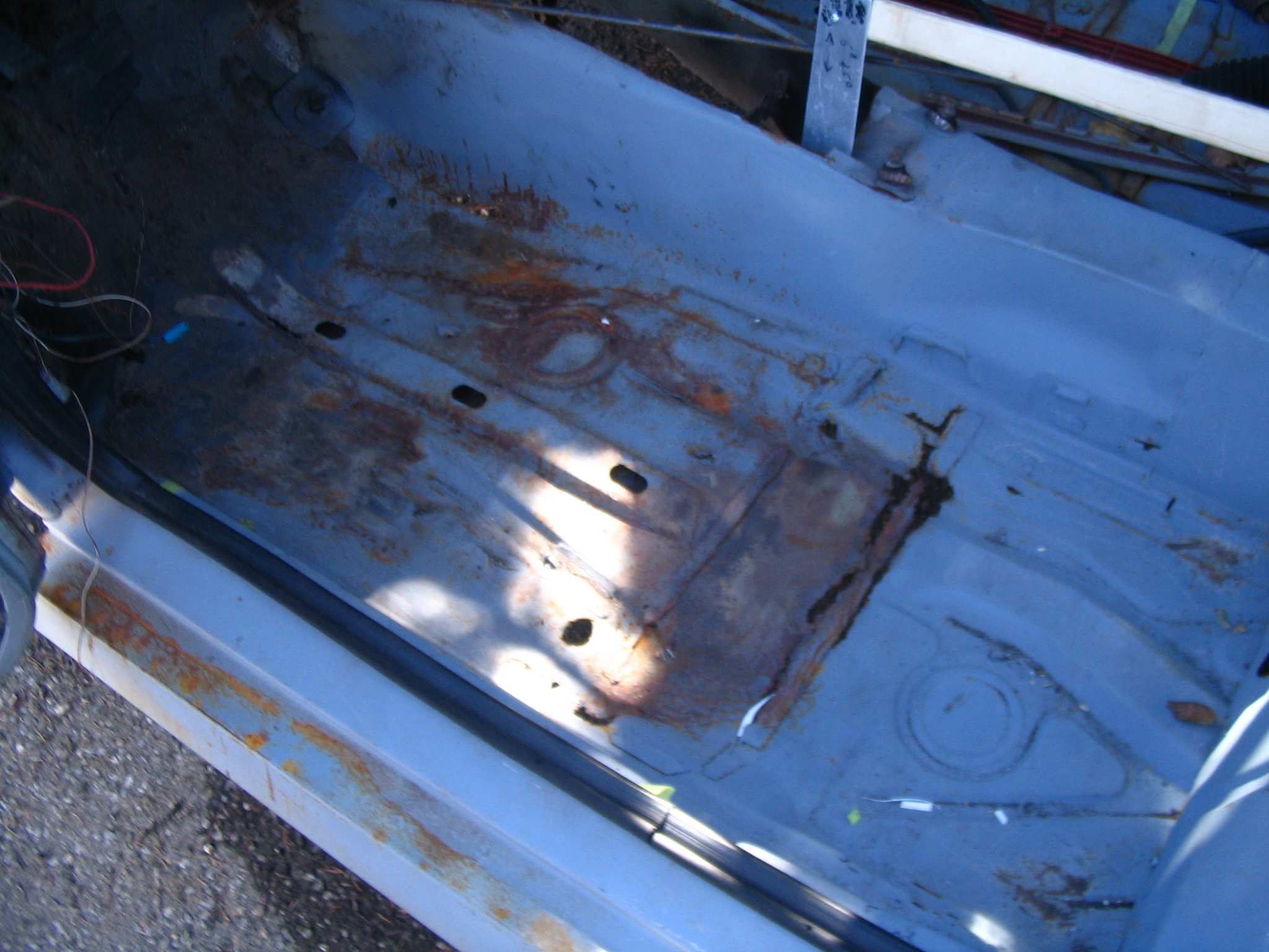

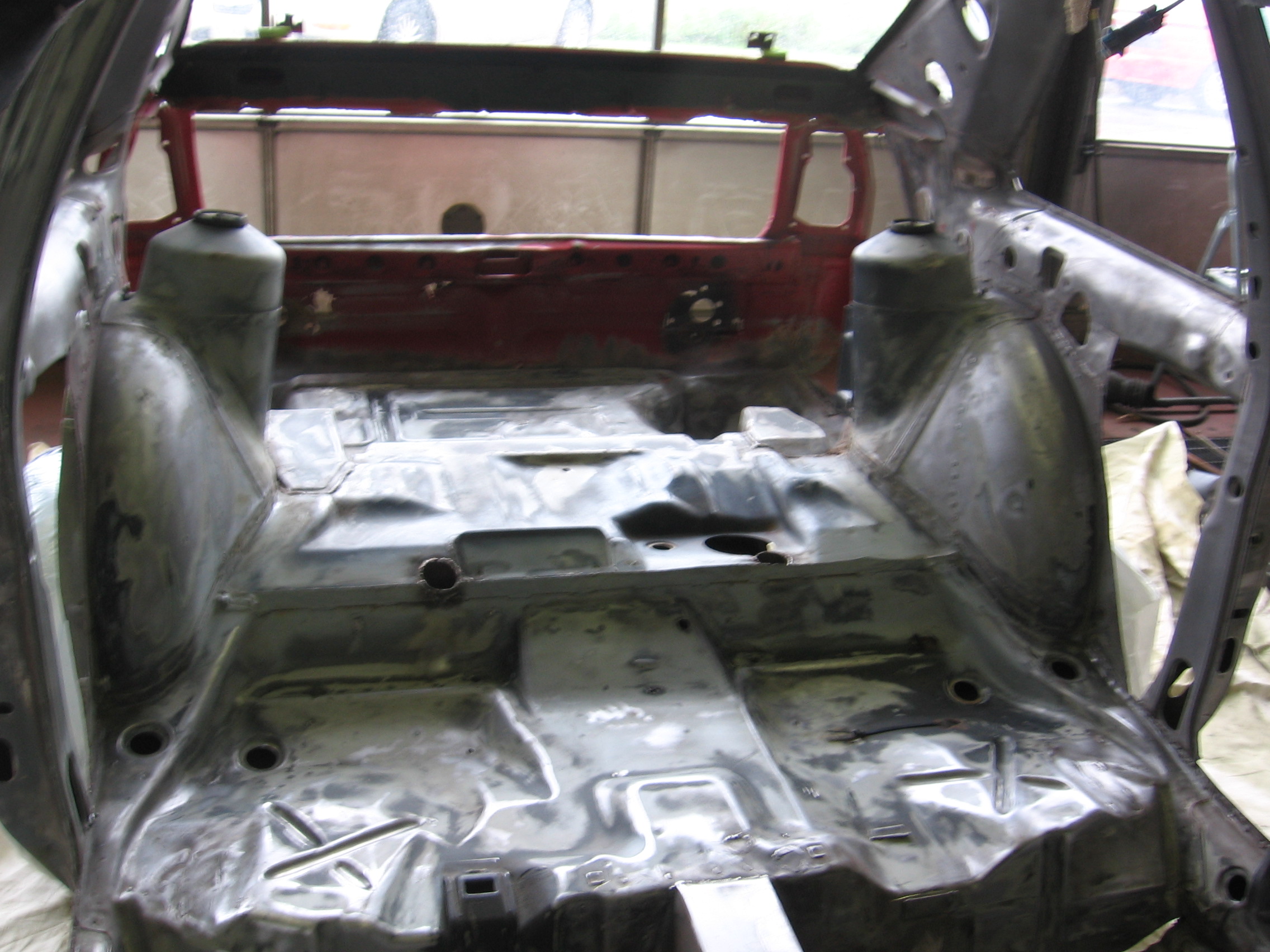

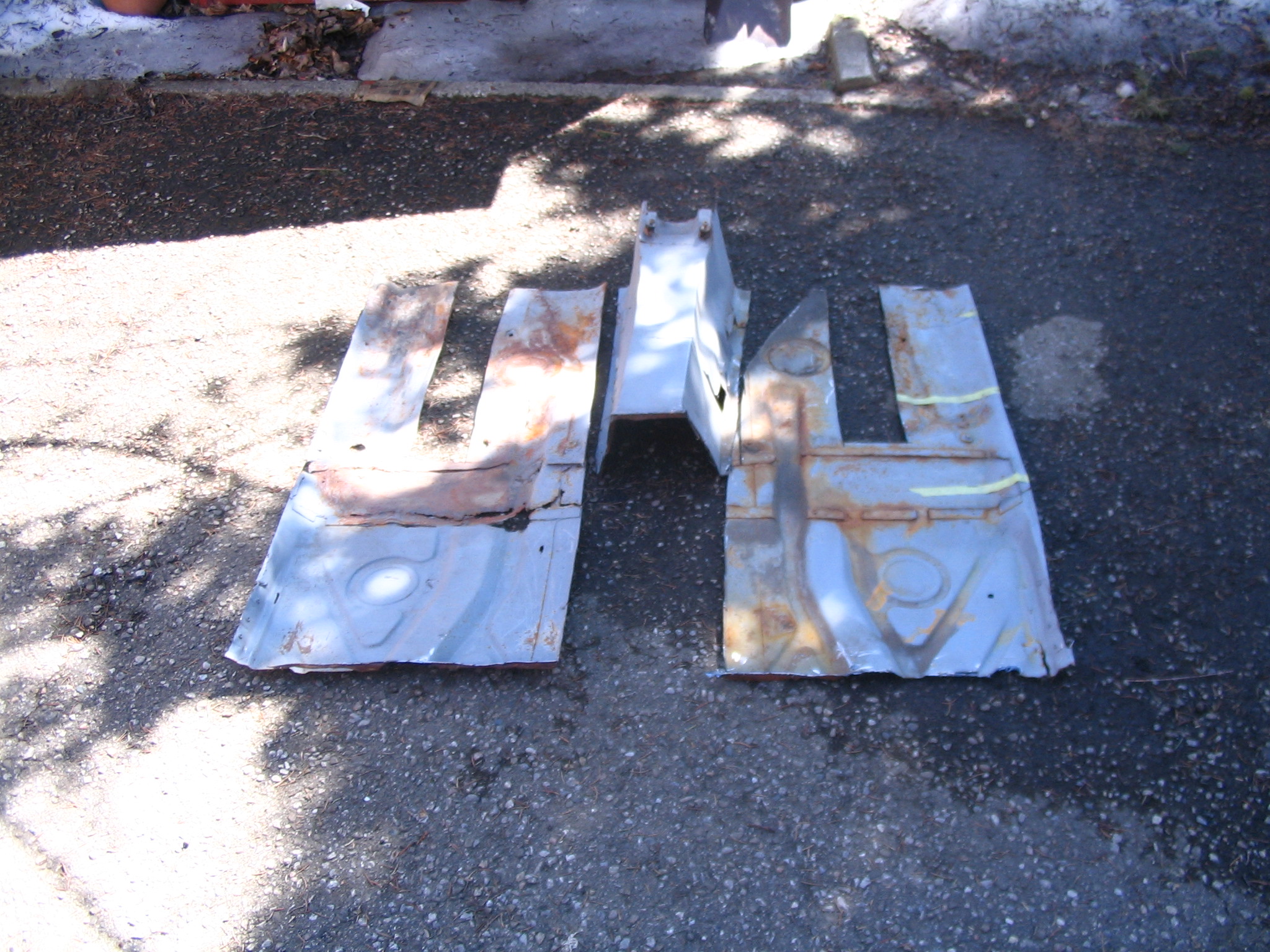

After drooling over Mike's floor on his sport quattro build, I though bollocks to this.
I spent the day cutting the floors out completely. I'm going to re- do the whole floor. It's going to
be better, and way stronger than the original sport quattro.
I'm also going to add box tubing like the factory rally cars, and my urq project.
Anyhoo a few pics of the day's events.
Cheers,
Craig
Cheers,
Craig
- IMG_1763.JPG (710.1 KiB) Viewed 36277 times
- IMG_1767.JPG (973.61 KiB) Viewed 36277 times
- IMG_1769.JPG (879.66 KiB) Viewed 36277 times

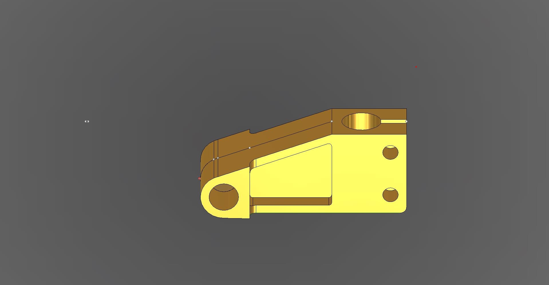

My floor is going to be extensively modified. This is the fun part for sure.
I started drawing up the gearshift assembly. The plan is to get it 3d printed to verify fit etc.
I've attatched a pic of the first part I drew for the shift linkage.

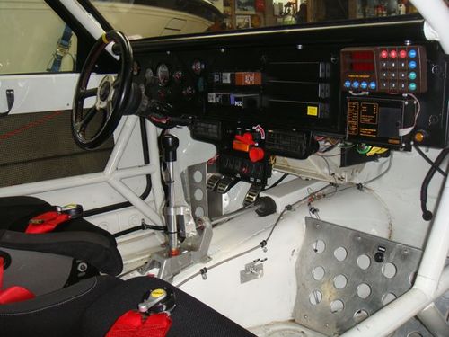

I would like to know more about how you are going about the Audi Motorsport shifter.
highlander69
- Posts: 279
PRA4WX wrote:I would like to know more about how you are going about the Audi Motorsport shifter.
Hopefully I will have some news about the shifter in the coming weeks.
Cheers,
Craig

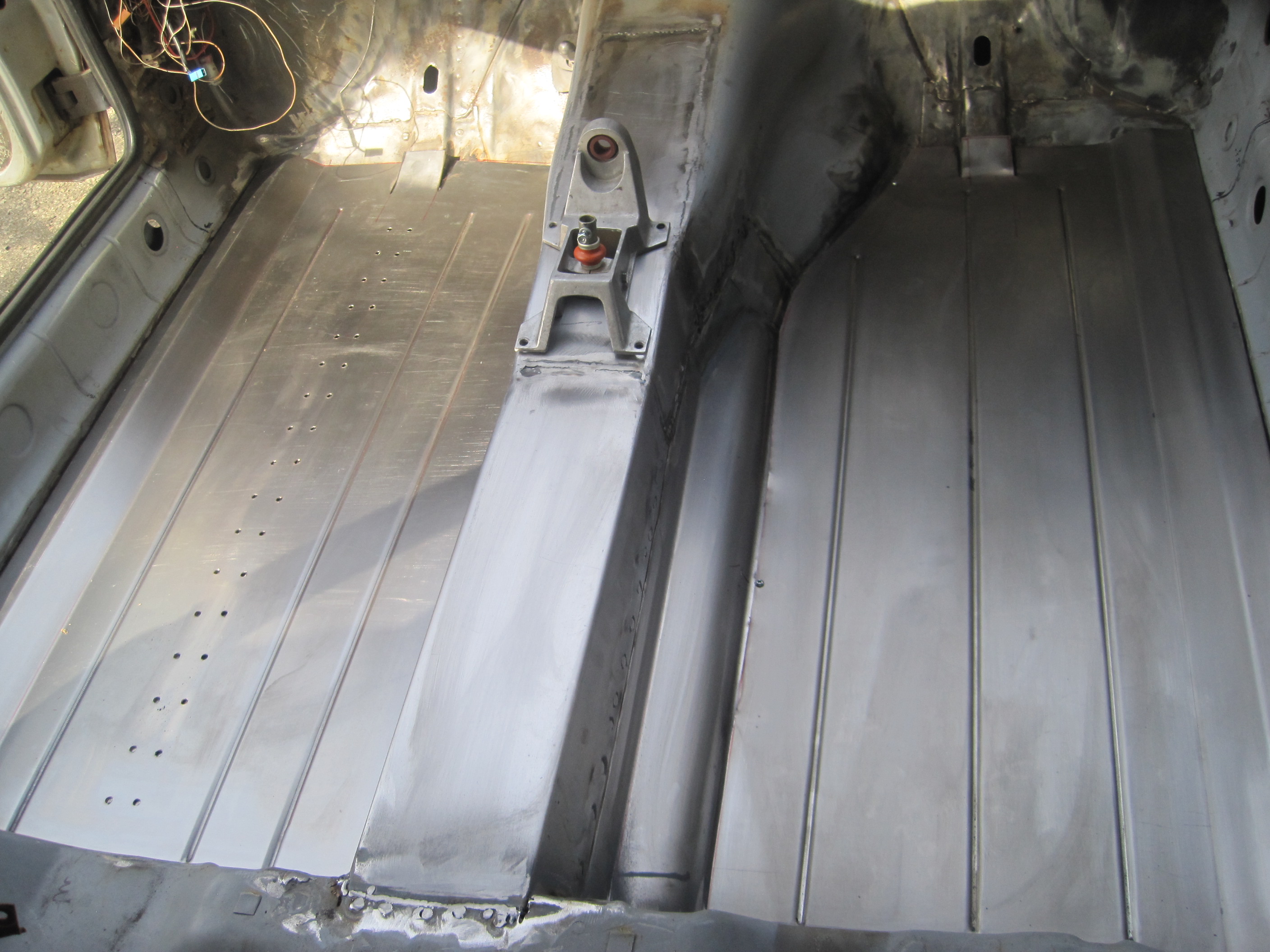

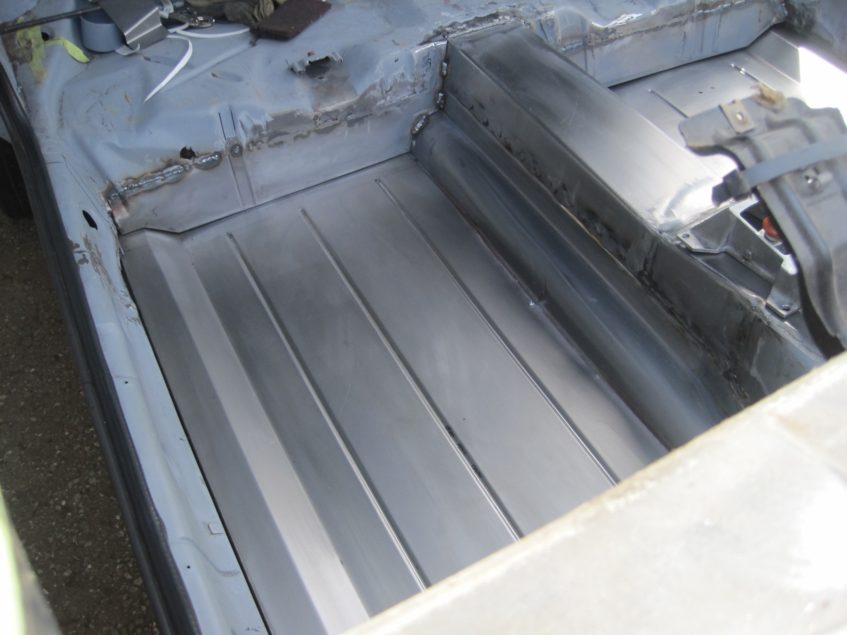

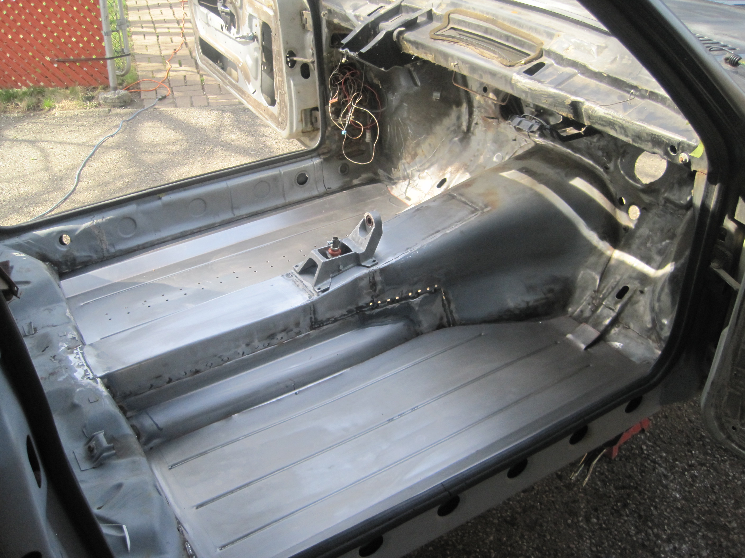

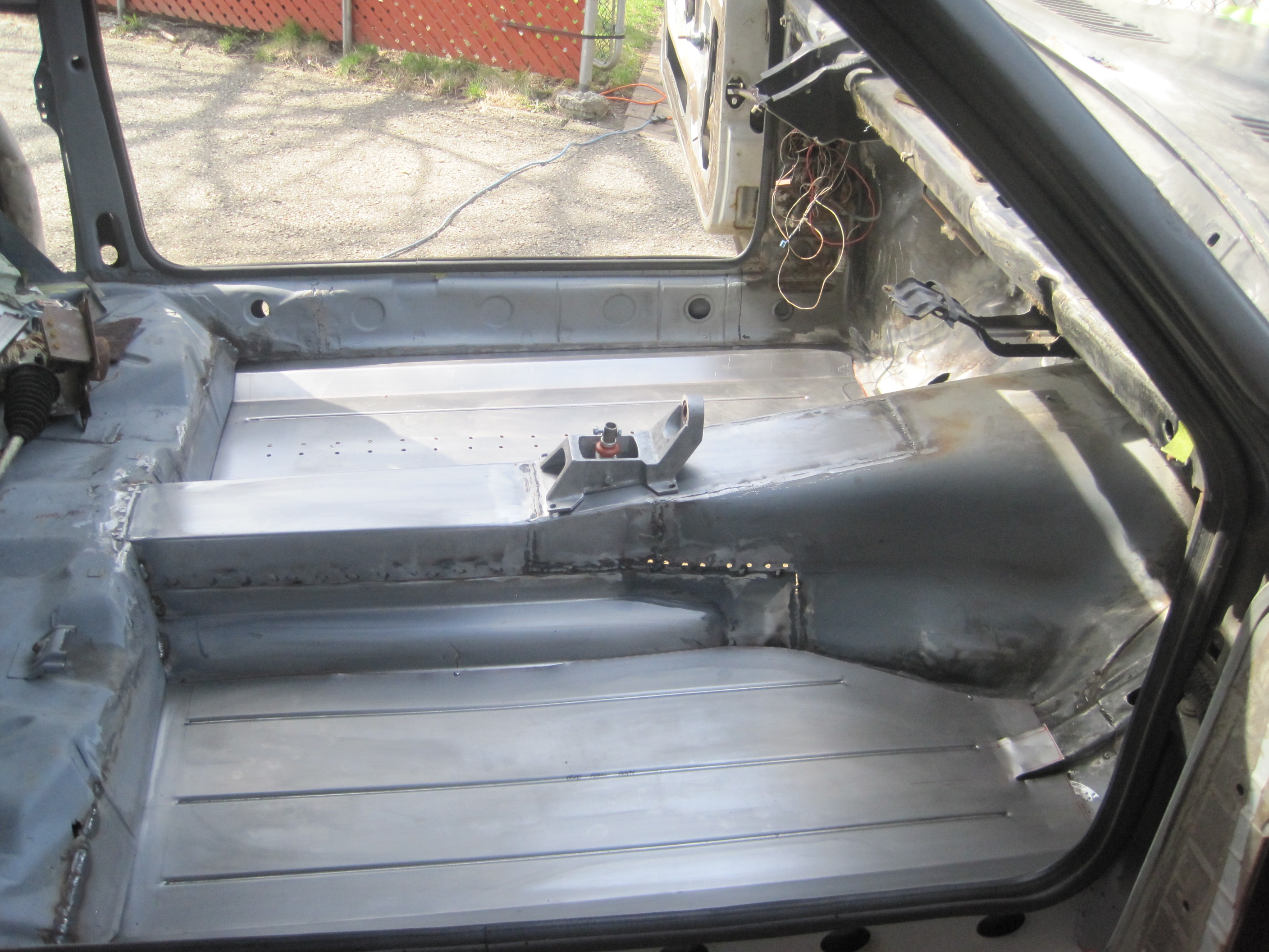

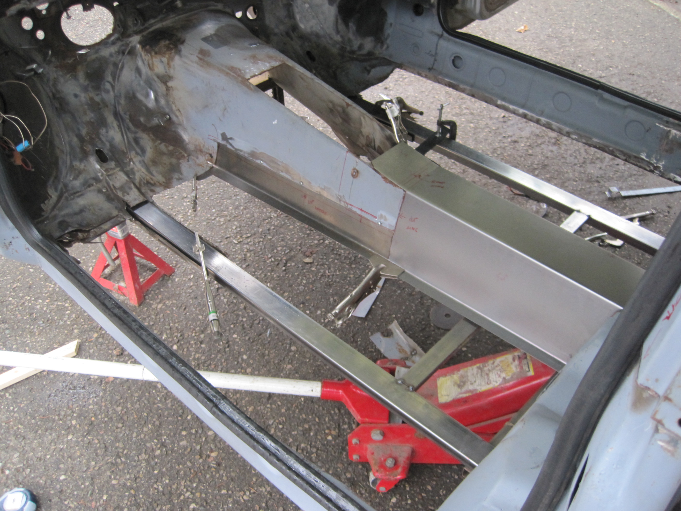

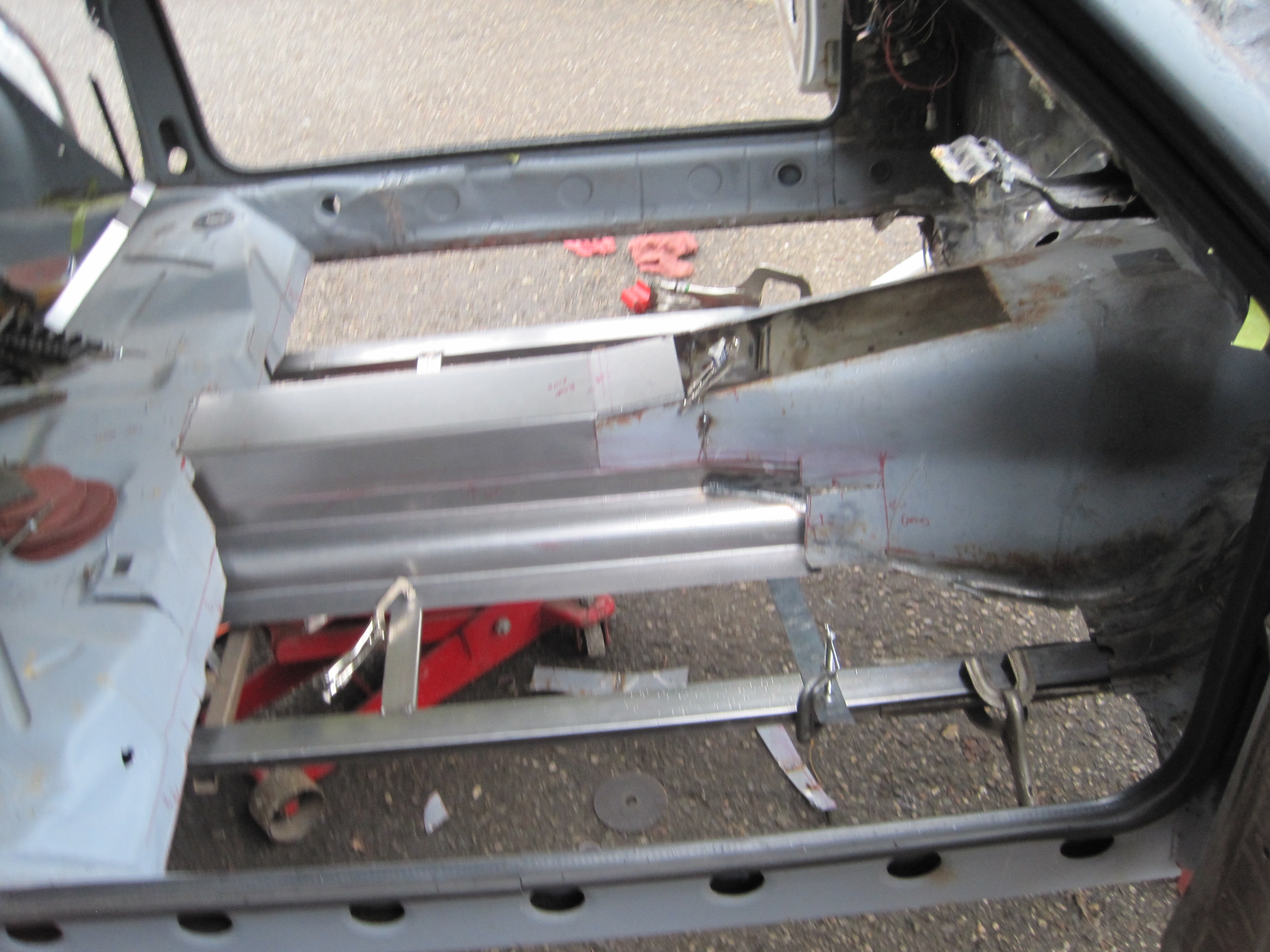

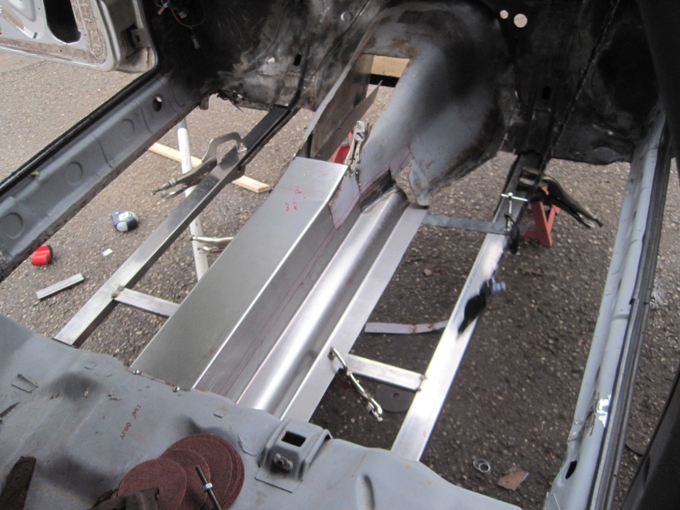

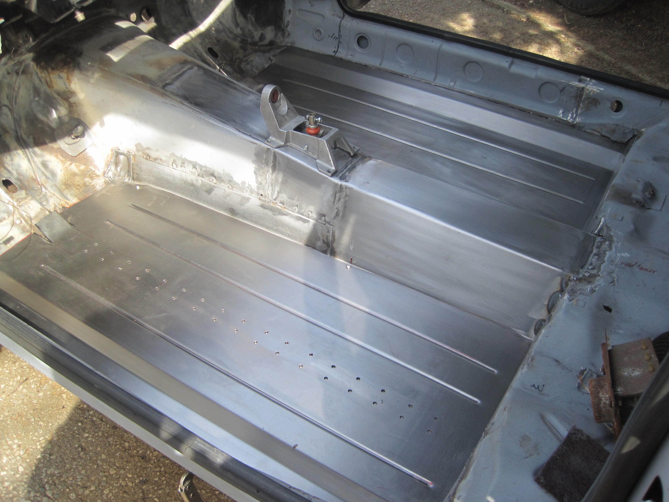

It may not look like it but I have easily over 10 hours in the floor so far.
I'm really glad I cut the floors out completely. It gives me so much freedom to build the floor the way I
want to.
I decided to use 2x1" tubing as opposed to the 2.2" tubing that I used on my urq floor. This dimension just seems
a little easier to work with seeing as I'm going to have a completely flat floor.
I also added a hump for the exhaust.
Here a a few pics of the unfinished floor. Not done yet but you get the idea.
Cheers,
Craig
want to.
Cheers,
Craig
- IMG_0488.JPG (1.15 MiB) Viewed 36172 times
- IMG_0487.JPG (1.28 MiB) Viewed 36172 times
- IMG_0486.JPG (1.3 MiB) Viewed 36172 times
