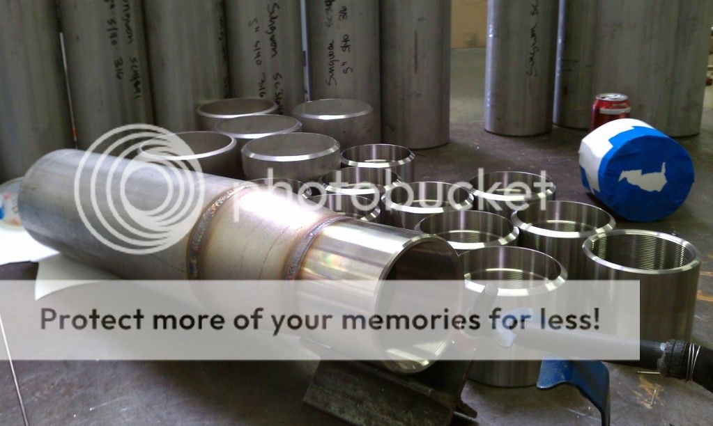

I do a ton of this stuff( have 50 similar parts to do next week) of schedule 40 stainless in 5" pipe variety. Consists of a root, 2 fillers and then a cap. My machine will run at 90% DC for 8-10 hours a day, 2-3 days at a time.

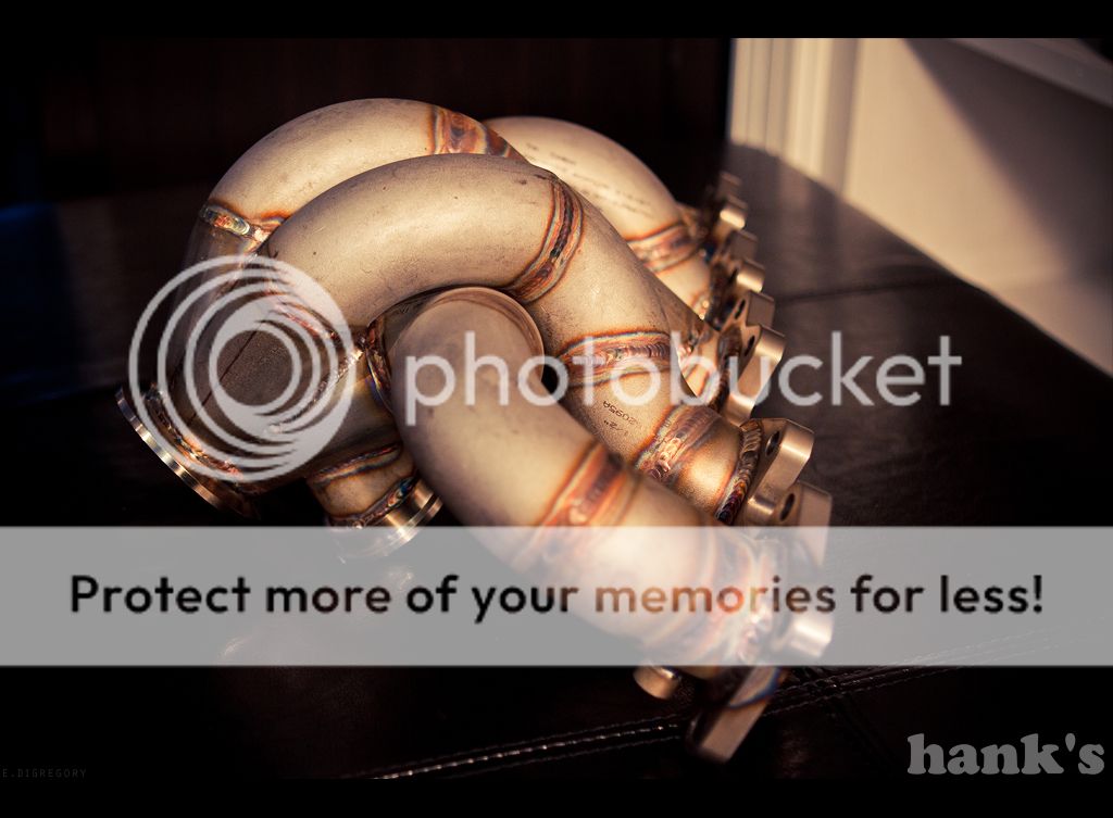

Imagine getting into the backside of the collector on this weld with the torches you have there at work...
Other thing is that most industrial, non aerospace, non high end automotive, are not using gas lenses for shield, which means the cups are not your typical 1" long variety with gas lenses. If you push the arc out 2" like most of the bigger torches are set up to do, you aren't transfering nearly the heat into the torch head as you would with a gas lense setup. With a lot of the heat coming from radiant, having a long cup goes a long way.

With good lenses, you can stick out about 2" before oxygen starts making it in. Usually pumping up the CFM is a no-no as well unless you were grossly under flowing. above 20cfm, you will start to be so turbulent that oxygen will get in via venturi at the end of the cup...
Careful planning is the ticket to getting a radial collector like this one to work.
