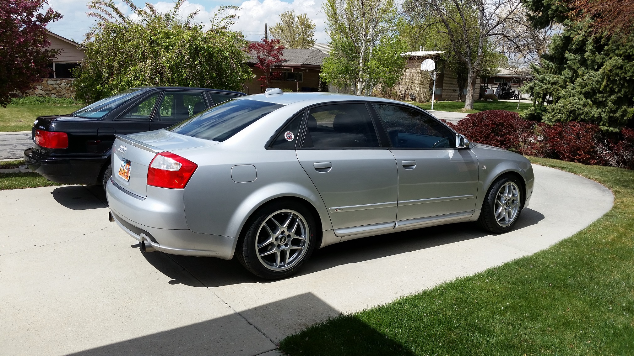

It was a somber day to see it go, He was a good car.
20150430_133751 (800x450).jpg (286.5 KiB) Viewed 19348 times
The new owner should get many more years of enjoyment out of it. He got it for a very fair price considering how much it had been modified.

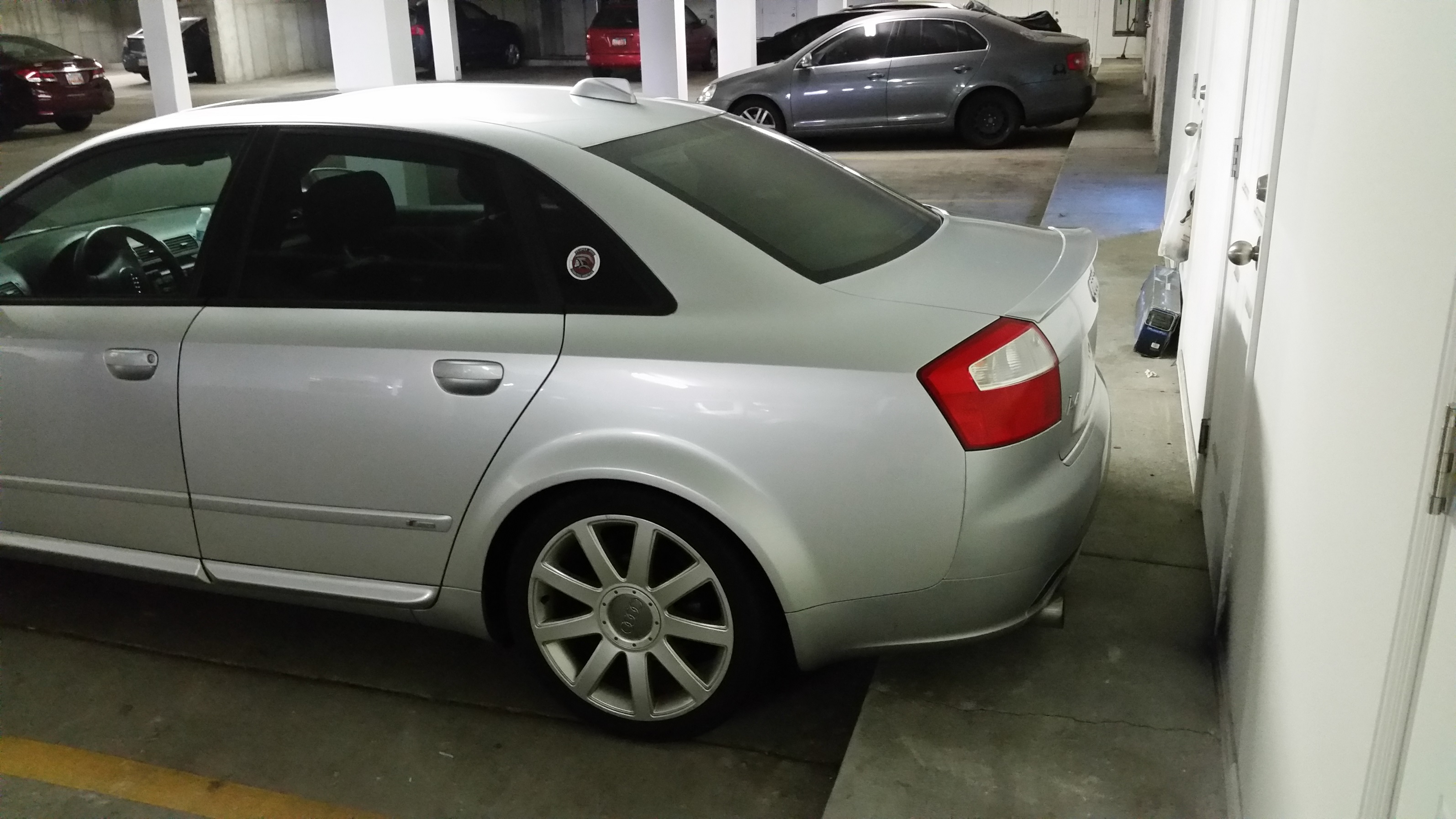

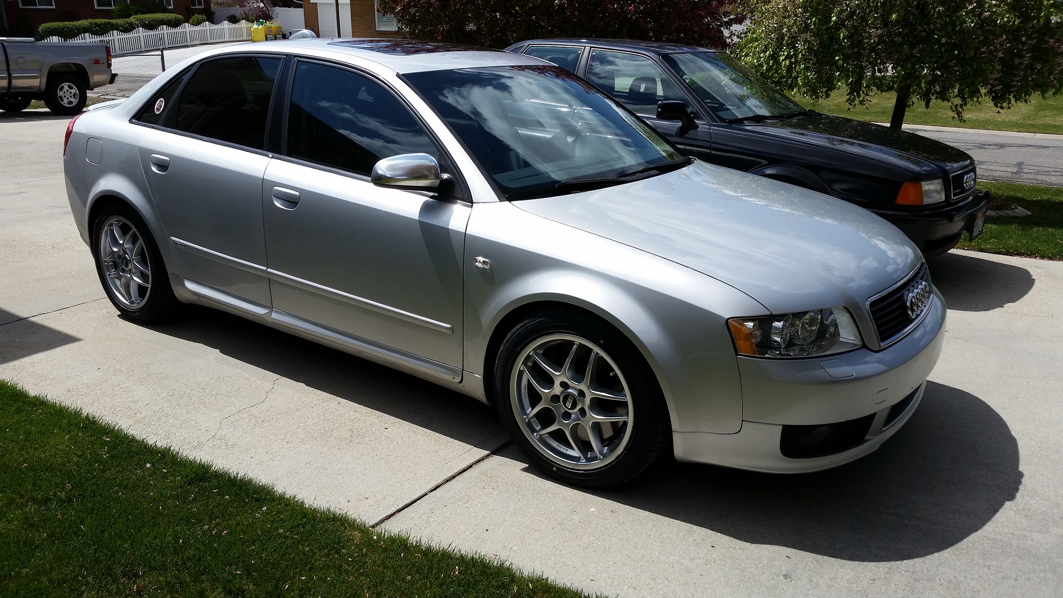

The new project is a 2004 A4 Quattro Ultrasport with a 6spd manual, 1.8t.
I then got a set of wheels from a friend. got a pair of S4 mirror housings, and S4 brakes with cross drilled and slotted rotors and EBC Red pads.

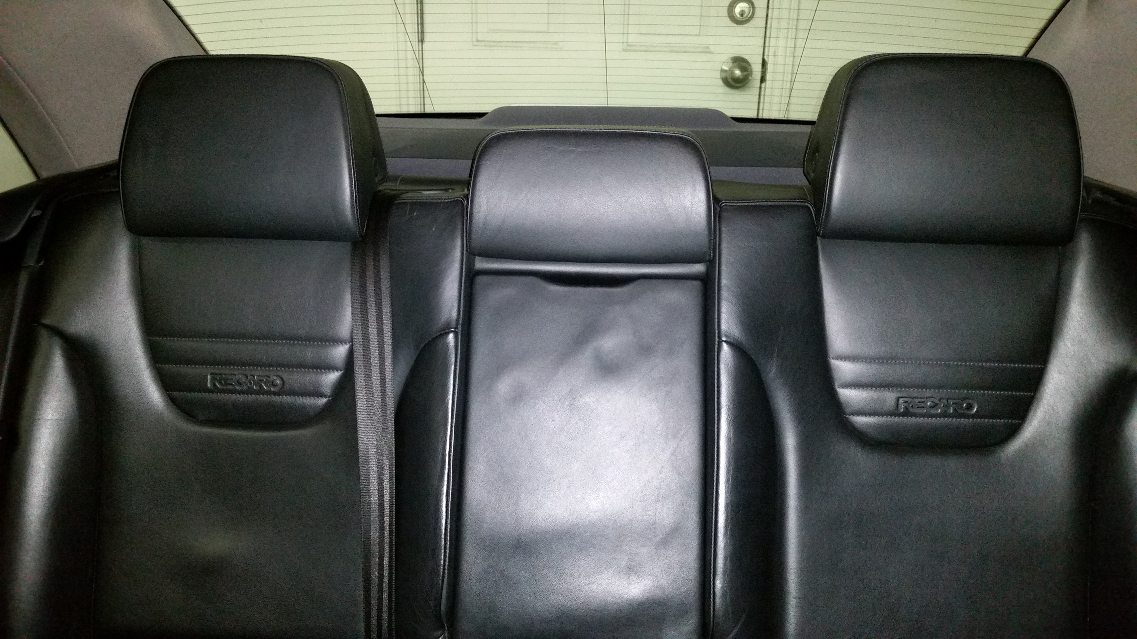

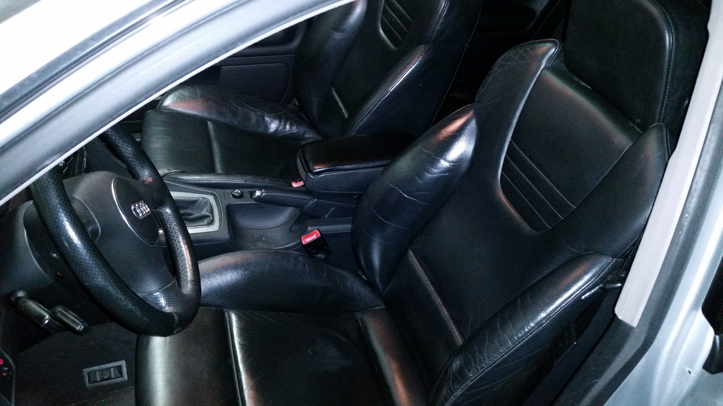

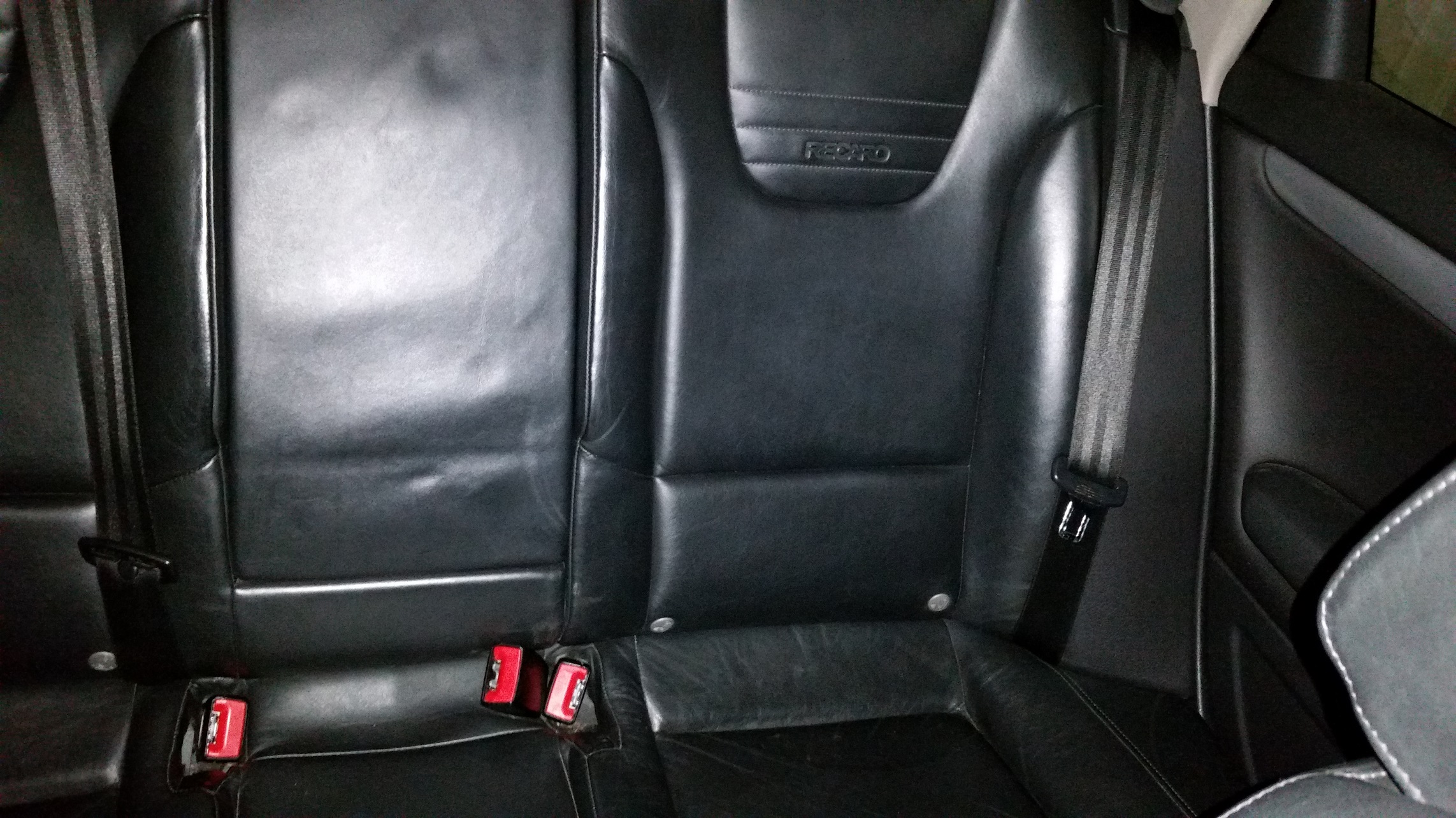

A few days ago I got a full set of S4 seats in ok condition. I have found the only big problem with them is the drivers seat heaters bottom and back pad do not work. I am in the process of figuring out what to do to fix it.

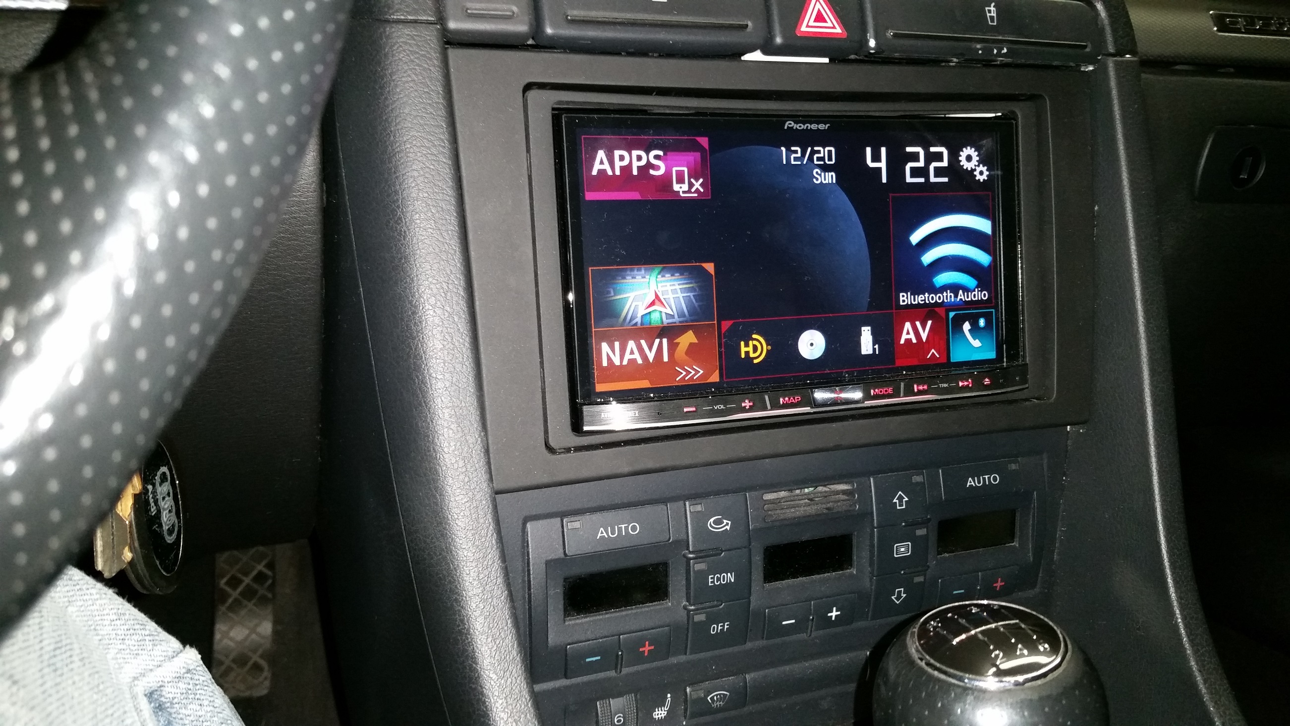

So far the greatest convenience upgrade I have made so far was a pioneer flagship touchscreen NAVI/Media center. I found that it is capable of playing multi variations of file type, and interestingly it does accept a 2TB portable HD. I now have a media system that holds my whole music library, and half of my movie library (1500 movies) at the touch of my fingers.
It really has turned out to be a nice DD.

Thanks! They certainly feel better than base model seats. I wish I had disposable income to do an 07k swap and be able to get around OBD2 compliance, but thats not in the cards for an 04 unless I buy property outside of the emissions boundaries. That however, is in the next few years plans. Im hoping to take a run of 3 or 4 months of field service for the company I work for. If that happens, it should yield a chunk of money to put down on a proper house with room for a workshop and a full sized lift.

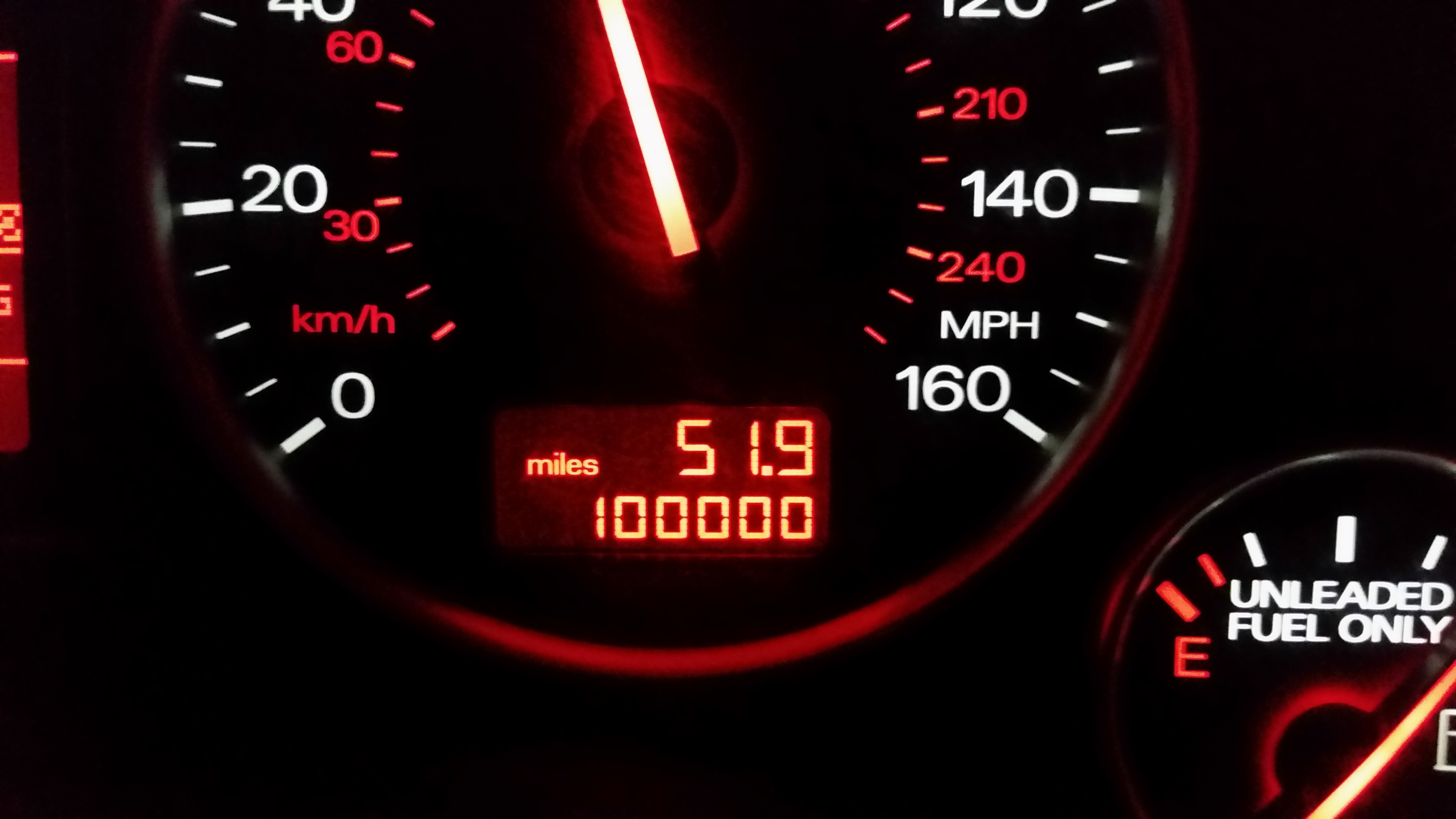

The newer car came to a bridge, and I crossed it.
100K Miles.jpg (888.82 KiB) Viewed 19053 times
I also have replaced the ignition switch due to intermittent no start problems. there isnt one Audi I've owned that I haven't replaced the ignition switch at least once. At least the failures are commonly predictable.

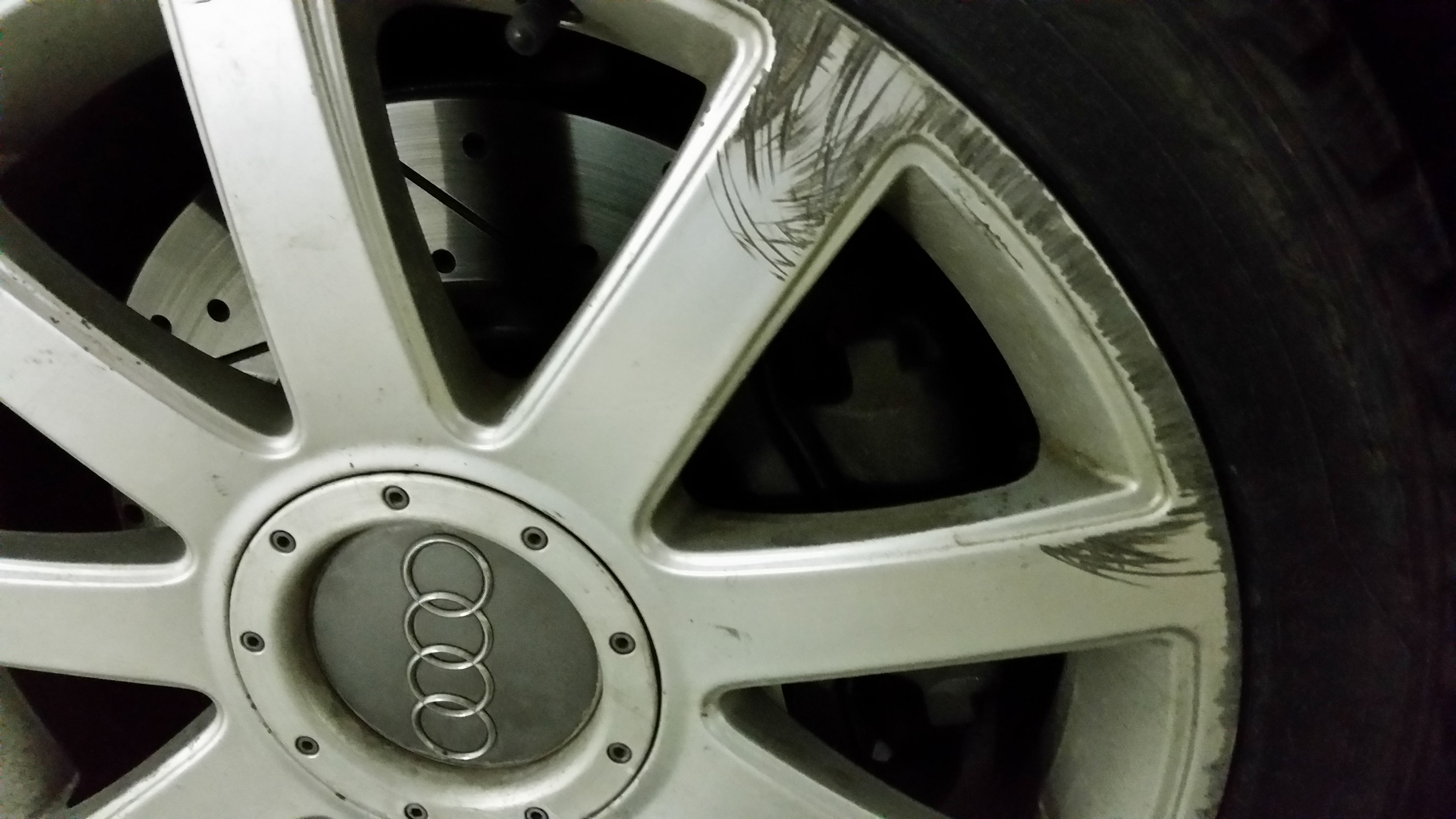

And now have S4 brakes with EBC Red pads and crossdrilled and slotted rotors all the way around now.
Yes, I know that is bad curb rash, not my doing. Previous owners must have been a girl since I found an imagine dragons CD and candy in the under seat cubby's that nobody seems to know exists including my brother.
The car is really coming together nicely. Now the only thing on the to do list is to replace the noisy when you first start it up cam adjuster. That is the only thing that has me worried about longevity in the short term.
