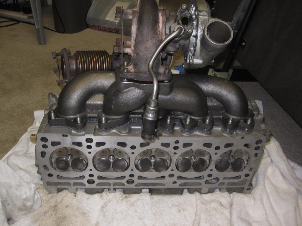

Alright guys, dilemma... I've about expended my budget on this turbo upgrade, have a little bit of slack to work with. Should I run a good stock mani or pick up an ebay rs2 replica and clean it up?

By memory, the OEM manifold is good to around 350-400 bhp. In that case, I'd say run it as is for now and save for a quality upgrade.
If I'm wrong, I'm sure someone will correct me.

For what it's worth, I bought an eBay manifold that was recommended to me on MG. It's held up pretty well for the 20k miles I've put on it so far, and the casting looks decent (didn't have to clean up much).
For the pricing, it was no question for the peace of mind I got that cylinders 1 and 5 won't run hotter, but when the time comes, I will spring for a high quality manifold. I can find you the seller if you're interested.

Is this the ho version or regular rs2?

I've been looking for that manifold, I have the regular RS replica on the shelf, it's ok. I've heard good things about those wagner looking ones but I can't find them anywhere now.

Here's some good info for comparison:
http://forums.quattroworld.com/s4s6/msgs/196904.phtml

Another option is a re-welded eBay tube header. I wish there was something between eBay crap and a $900+ upgrade. I could maybe swing 3-400 but an IMS or real Wagner manifold is out of the question unfortunately.

Well I think I'll be sticking with the stock manifold till it becomes a restriction. I'll take a look inside and see if there's anything I can do to clean it up, but looking at the numbers I'm not even sure the RS2 copy is worth it flow wise.
