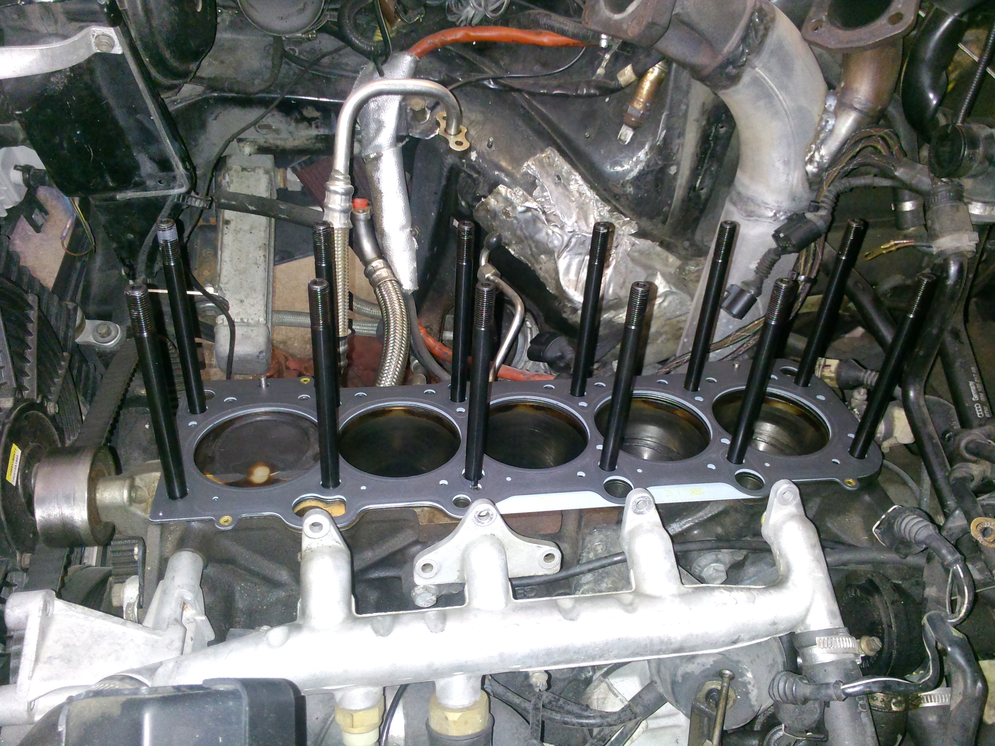

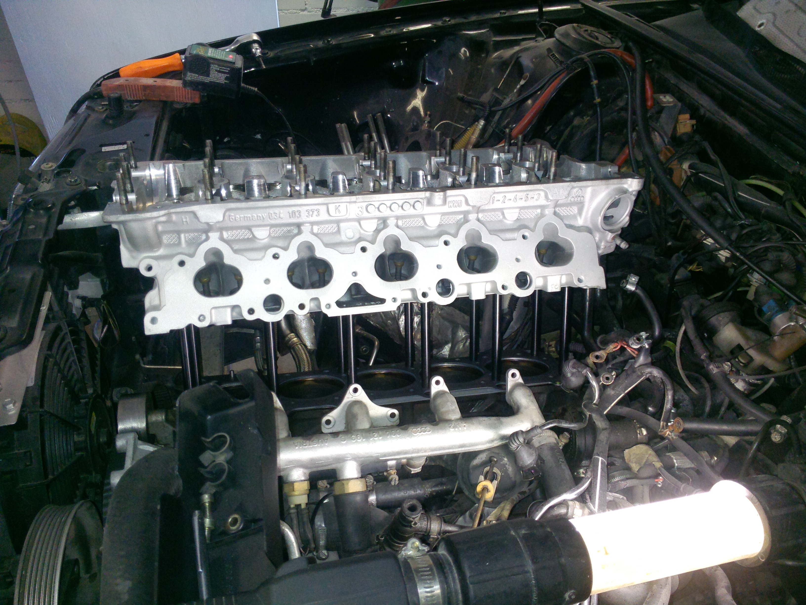

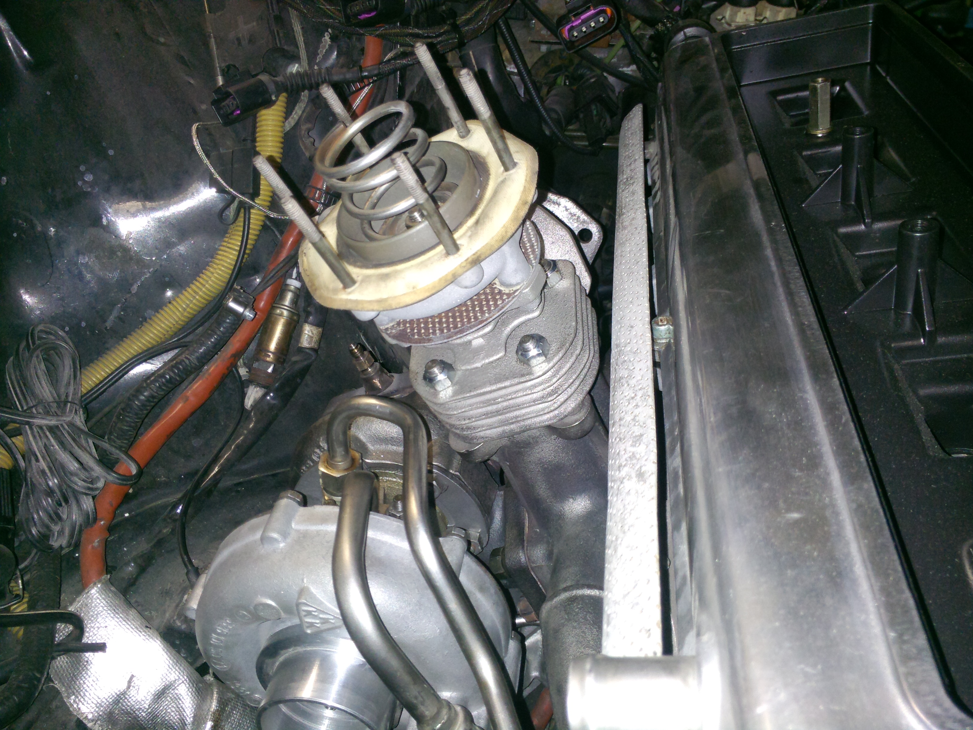

Head studs Installed...
Head Installing...
Head installed and torqued...
I also have swapped my turbo cams into my 7A and vice versa. I have installed them but have not a pic at the moment.
I also decided to polish the inlet of the Billet K26 turbine housing and should be done with that by tomorrow. I have been debating shaving the compressor housing and giving it a polish like the Volvo, but given time constraints may leave that till after BBQ.
This would have been posted much earlier, but Im having issues with the tablet. the only browser that will post pics without giving an invalid is firefox, and it crashes constantly while trying to post on this thread. Subsequently I keep having visions of stabbing a knife through the tablet, but come to my senses after I realize, at least its not an Ipad. :guns:

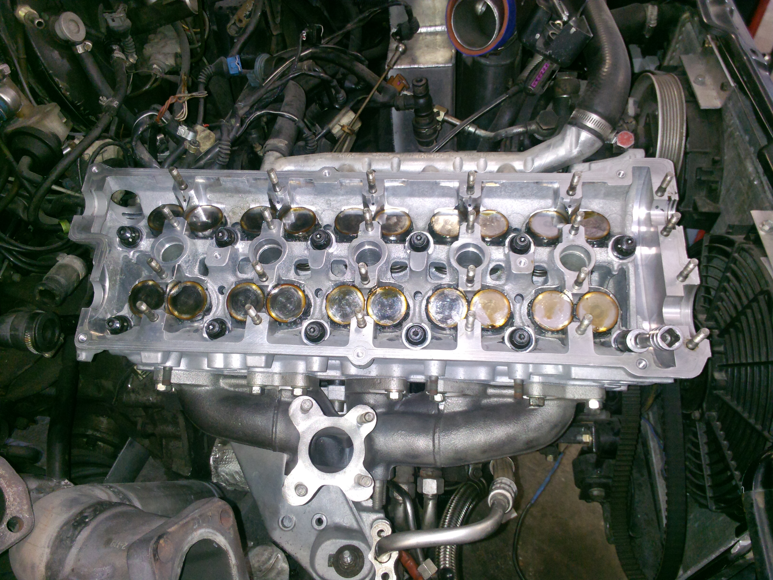

Ok, so I got a pic of the cams installed...
And I also painted the inside part of the valve cover flat black...

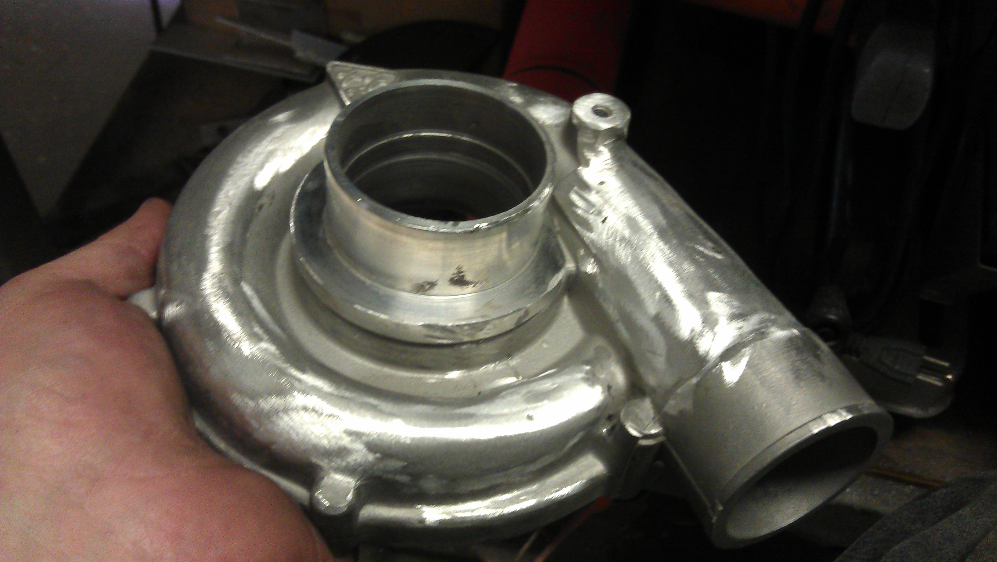

Now while I just sold the volvo turbo to Jared, I made some changes to the billet K26 I figure may or may not help. I decided to polish the inlet of the turbo as far as I could get in there.

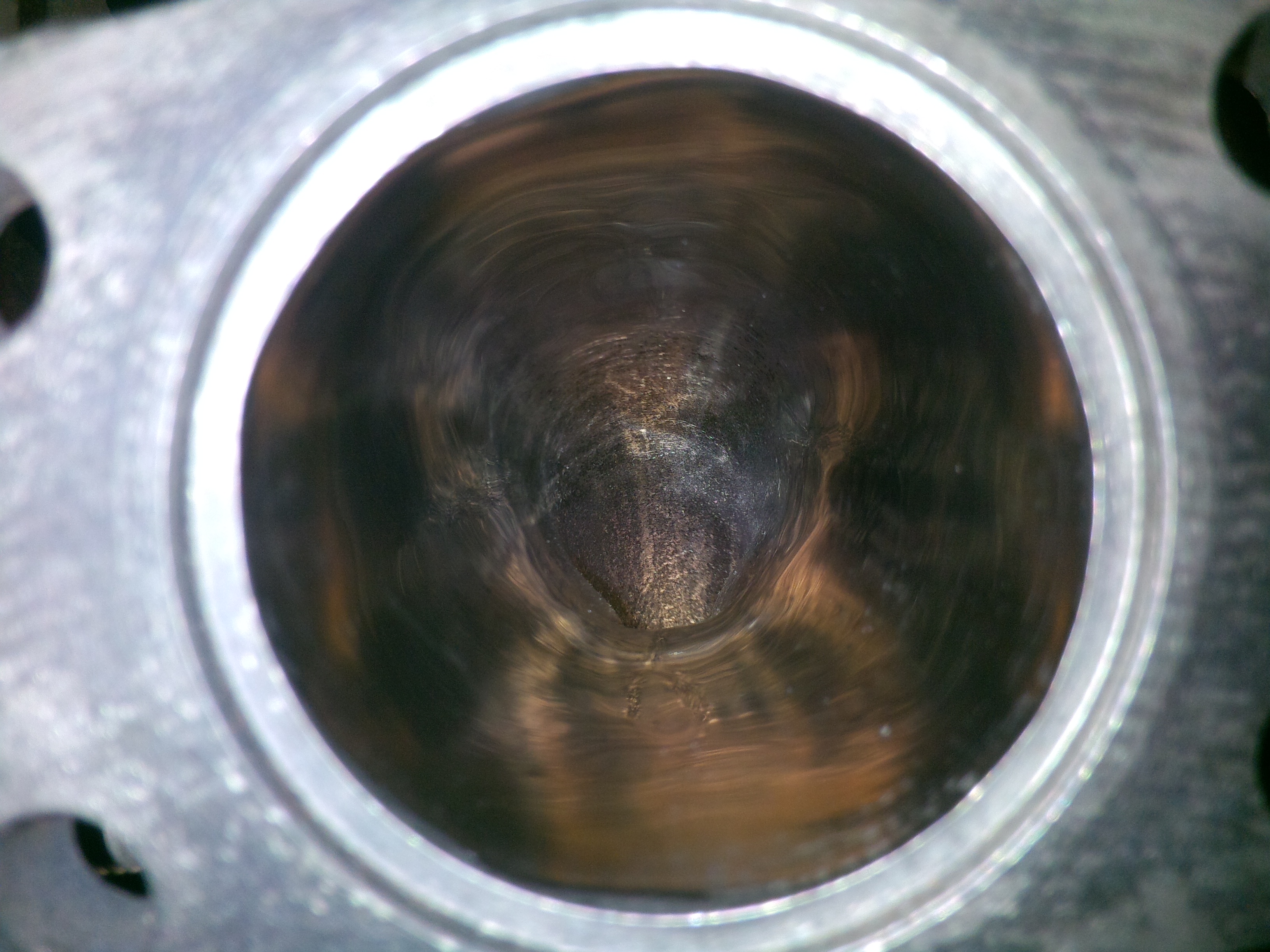

Here is one of the finished product. Its hard to decipher what you are looking at, but since the walls of the inlet are like glass, its ...very shiny.
Now since the exhaust manifold is so clean and new looking I also put the wastegate through the beadblaster.
I couldnt help myself with the compressor housing. I just like a clean look.

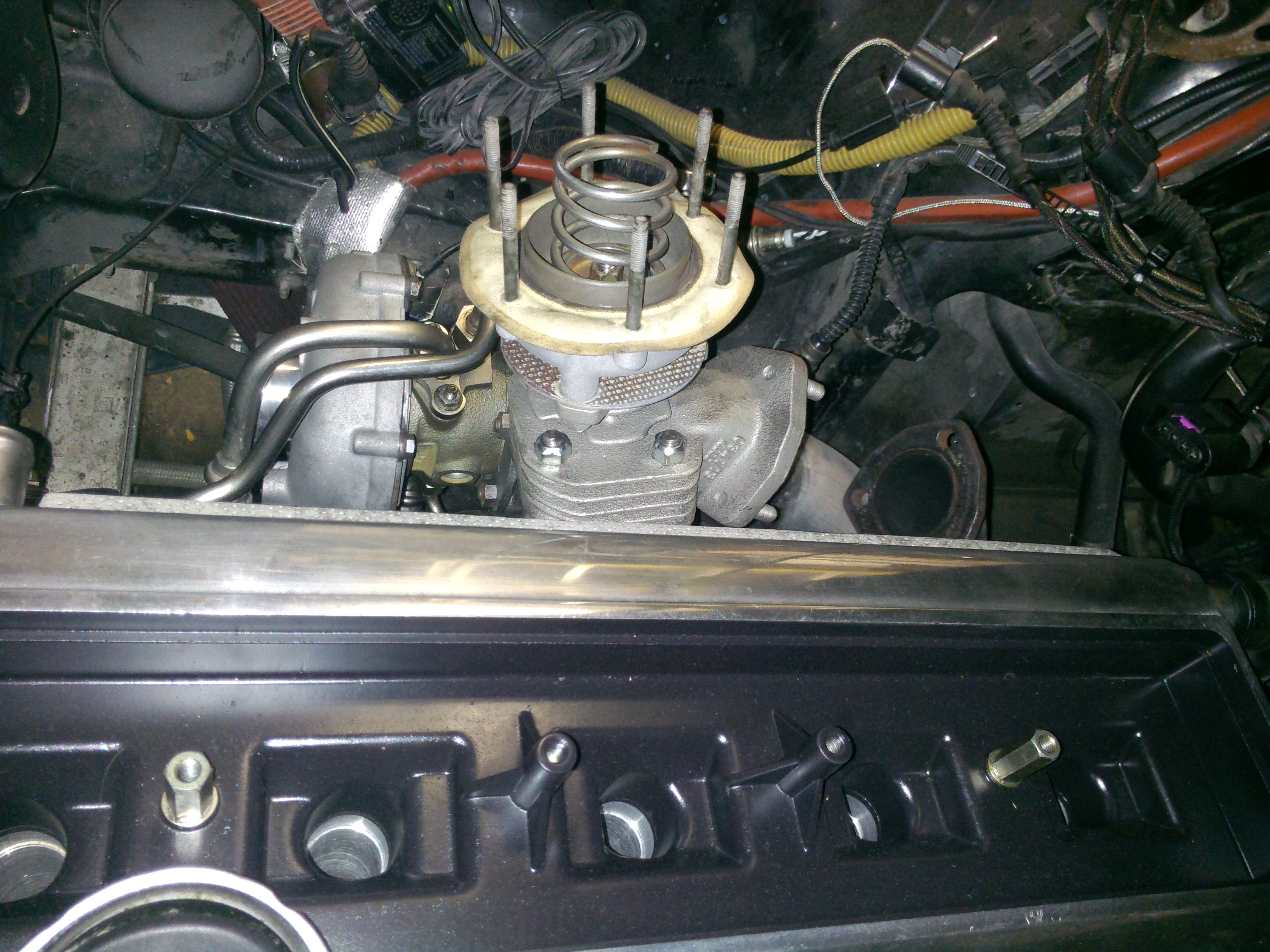

and today I finished up the reinstall. I have everything done but I need to get some hose to finish up with the diverter valve. with all the changes, thats all I have to go get from the parts store. I did however have to cut the oem inlet hose, but it still works the way I need it to.
And the compressor housing finished. I decided not to polish it but leave it looking smooth like just out of the bead blaster.

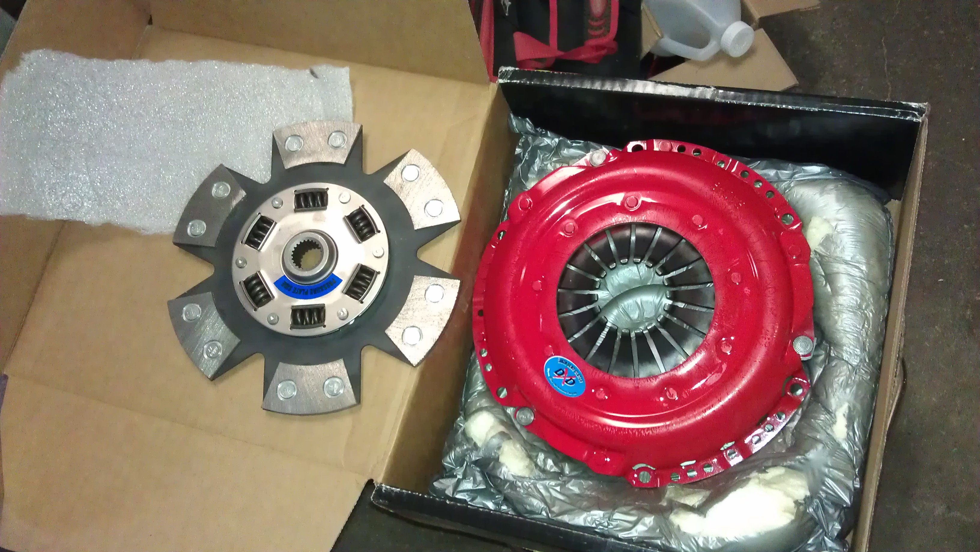

I got a package from Marc earlier in the week to fix the minor problem with excessive power.
This should rectify this issue very nicely while allowing the power to get to the ground. I never got to feel the true potential of my engine and the tuning we performed at the last Battle Born get together. Very soon I will begin the teardown for the last of the upgrades to take the engine to its most potential. It will also be the chance for refining the front mount radiator/heat exchanger/oil cooler and how it all fits together efficiently without modifying the core structure and headlights. there isn't very much room up there, so it will be quite a challenge for sure. I really want to keep the radiator up front, and would hate to have to make a major change in direction regarding its location back to side mount.

nice clutch :)
the other piece of good news is you can more or less ignore your intercooling issues on e85. Latent heat of vaporization means you can pretty much ignore high IATs. pump gas, a different story, though...
