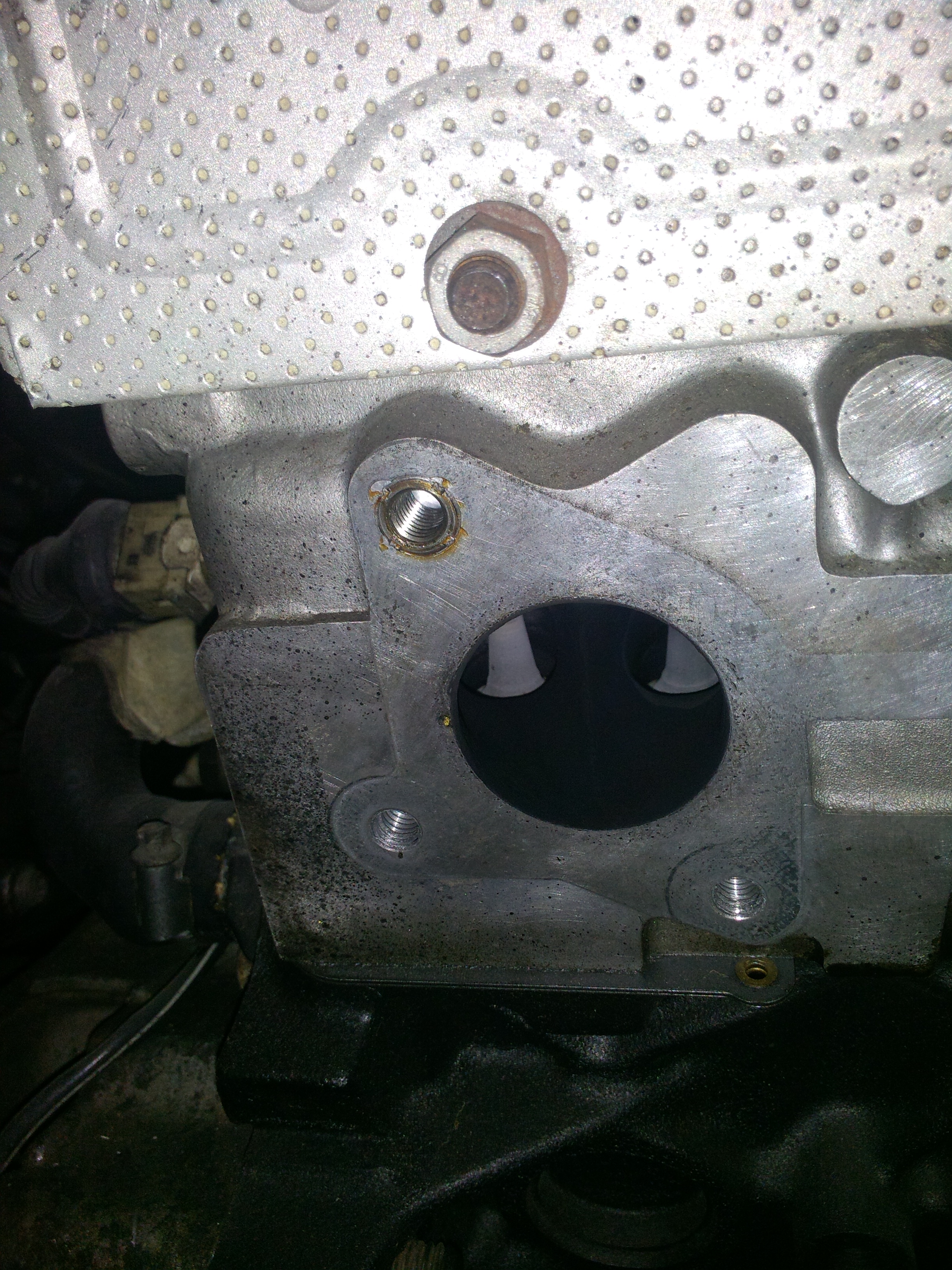

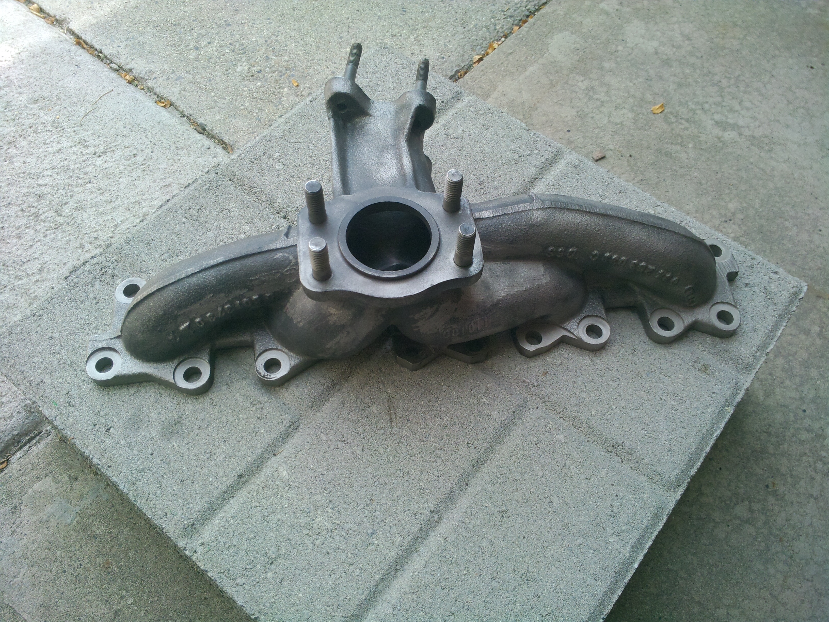

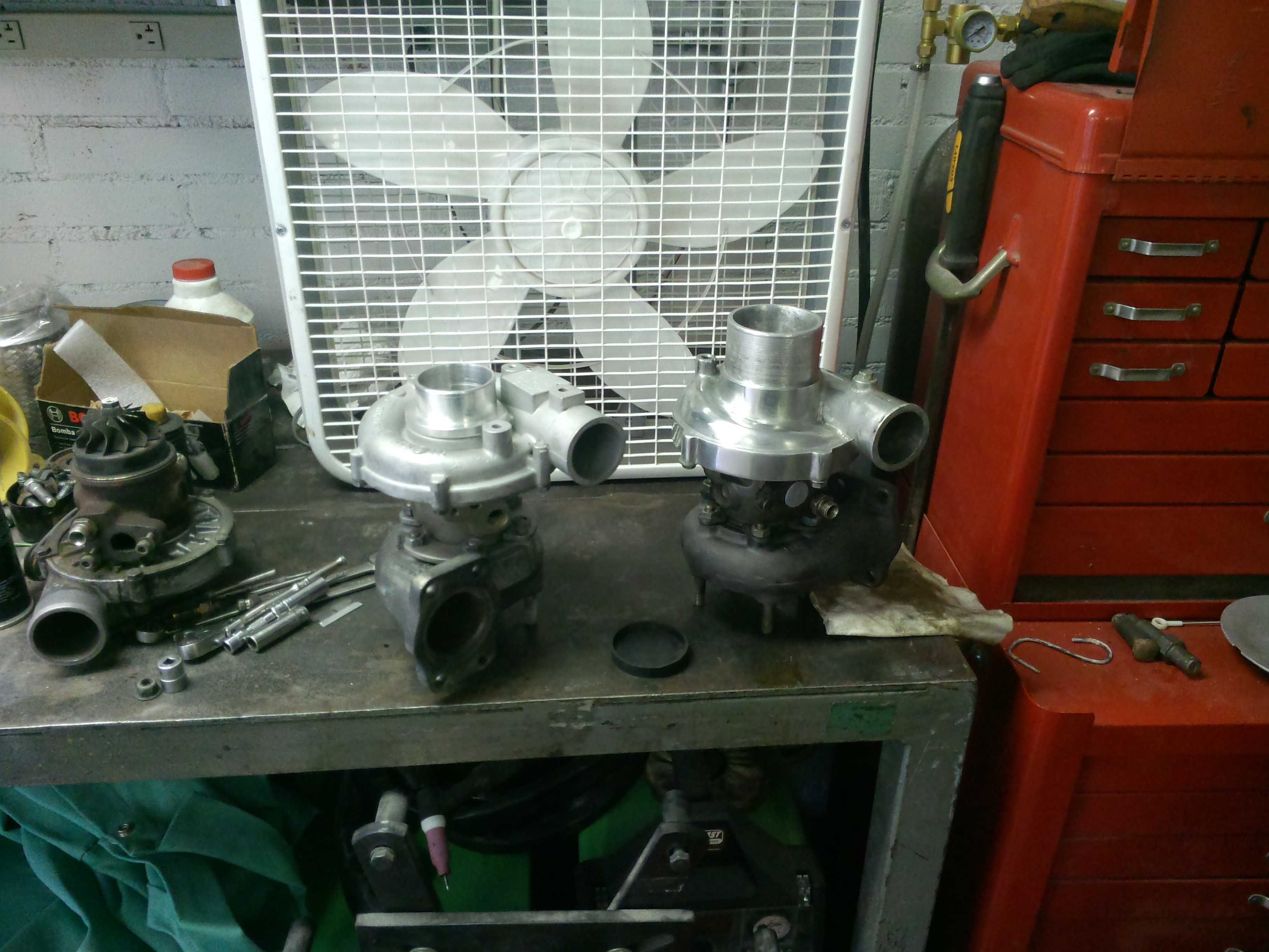

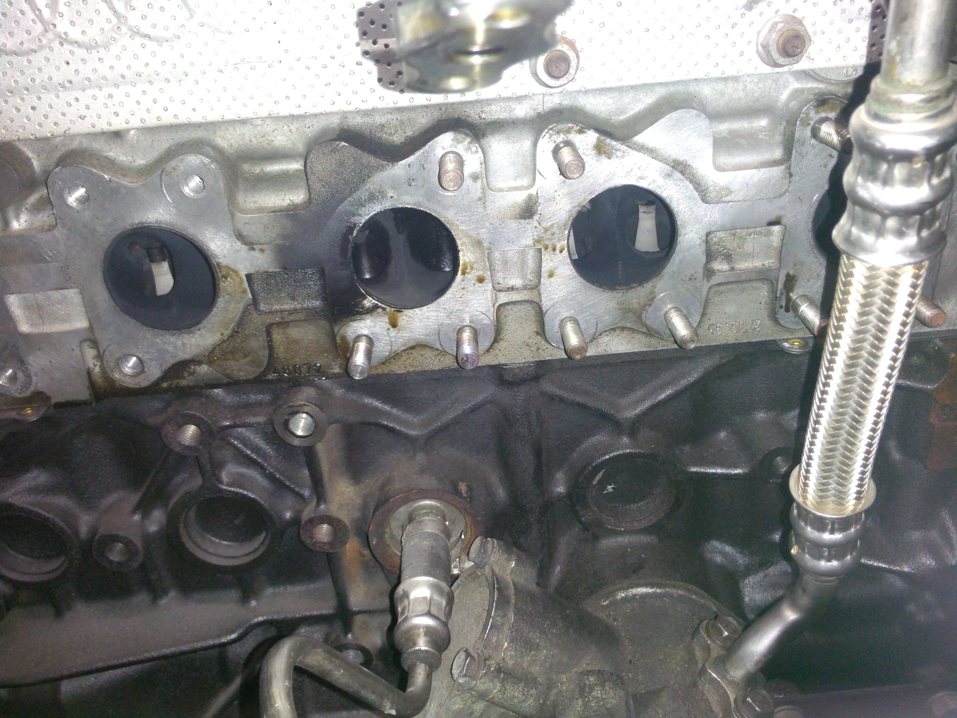

ok, since I have been put on furlough till further notice, I decided to pull the turbo off for Jared. I also decided to take off the rs2 exhaust manifold as well. I did find something hiding behind it too...
good thing I have new exhaust valves to install and intend on a 3 angle grind, as the seals are likely the problem. I did however forget to take a picture of my repair on a stripped out exhaust stud the only right way I could. With a threaded insert, Helicoil was never an option for me...
I put the EM through my bead blaster to clean it up. It does look a lot better...

85oceanic wrote:What turbo are you going to run instead of the Volvo one?
Is that billet K26 goodness in the middle?
Re: CQ project, the road less traveled (whoa, I updated this
Posted: Fri Aug 23, 2013 11:25 am
by scubadave
SHO NUFF!

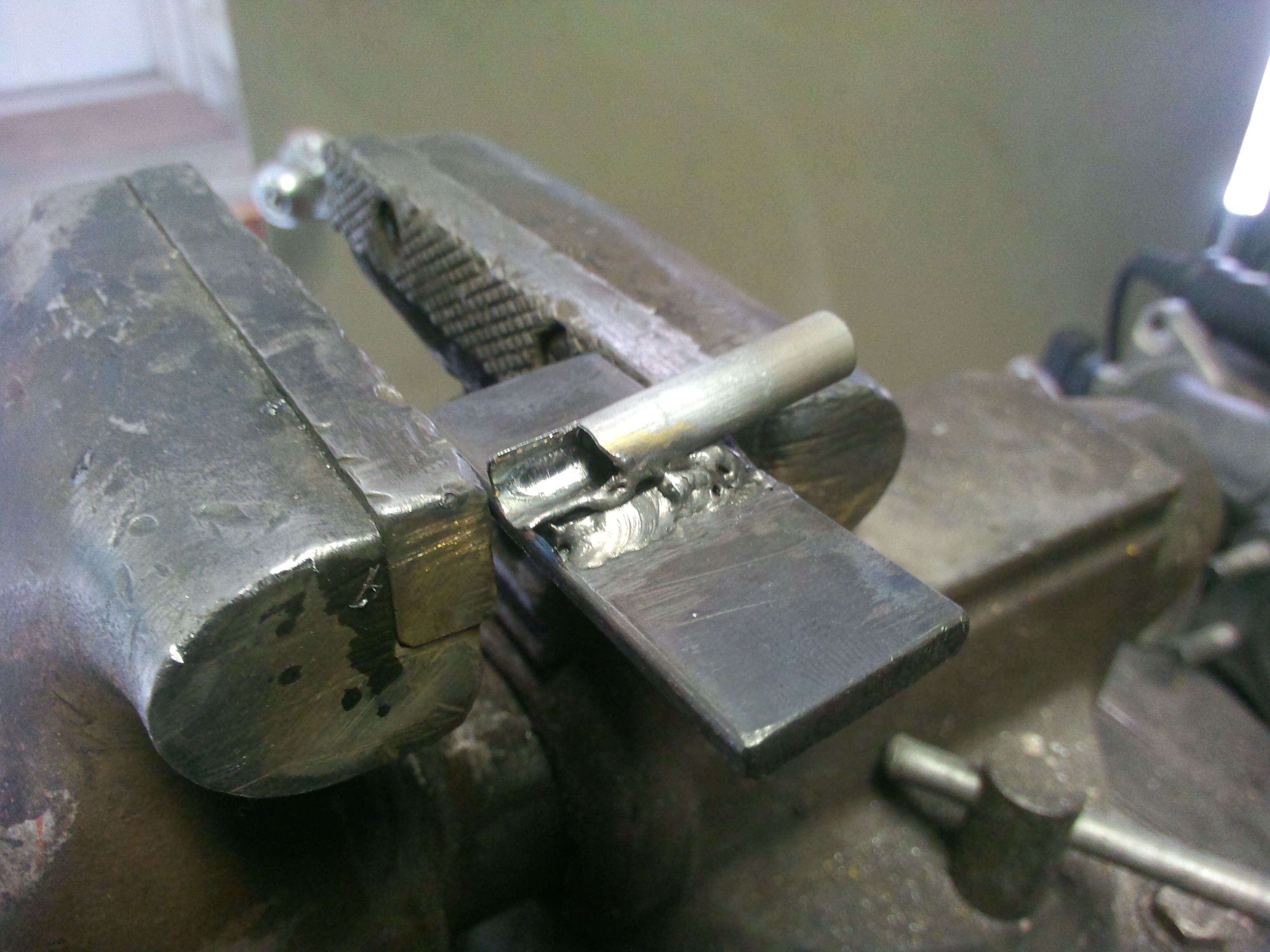

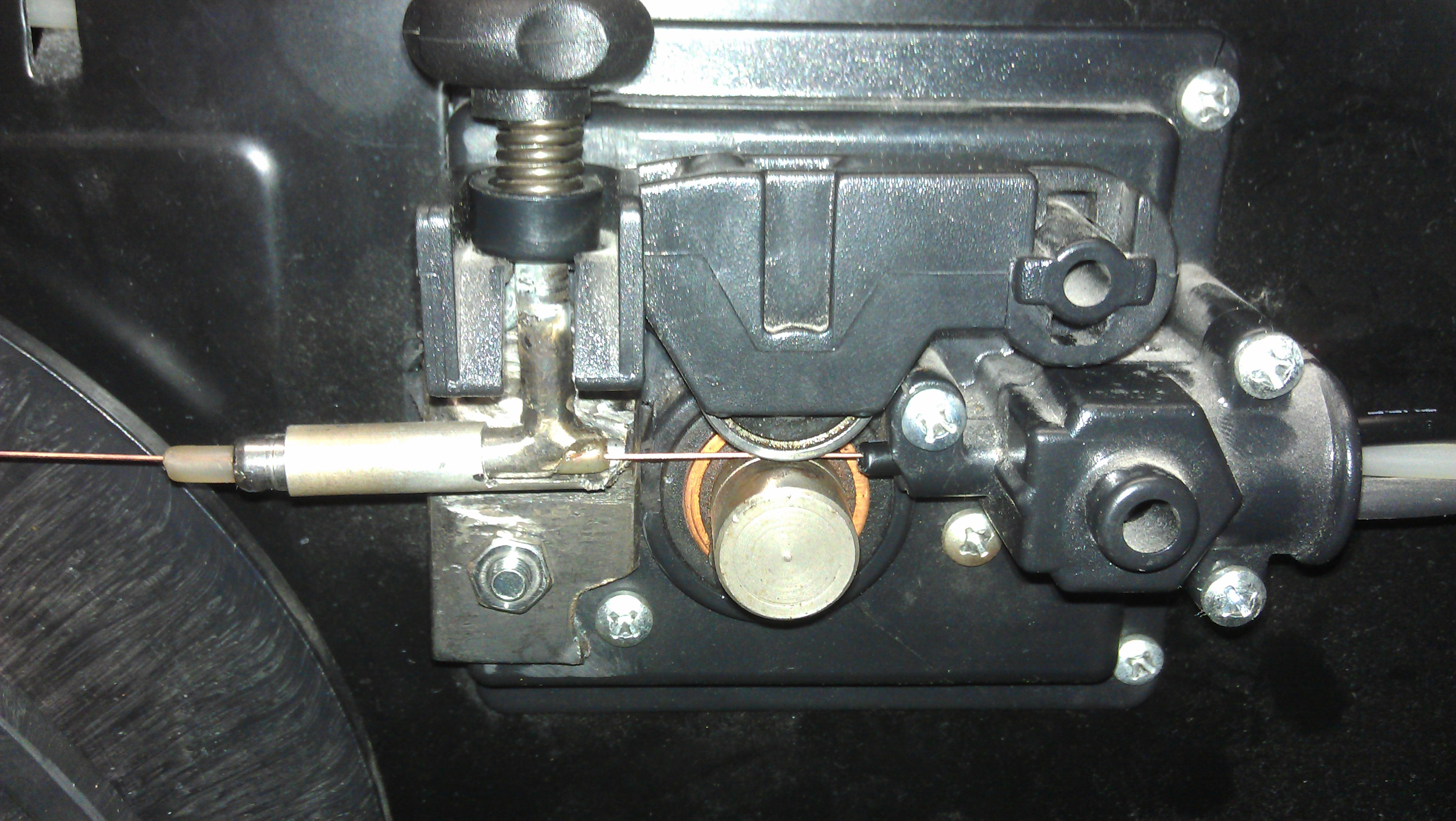

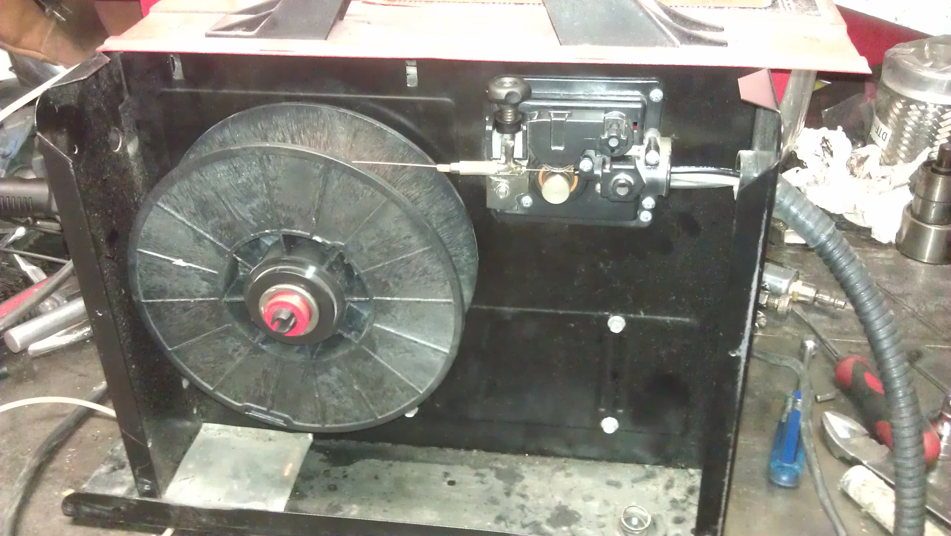

So, back in the day, 25 years or so ago, I convinced my dad we needed a mig welder. we got one from NAPA. recently, I figured out it was a rebranded Italian welder by the name of Cebora. well, for the longest time, I have been using it broken...as in, the clampdown for the wire was all made out of plastic. I tightened it up one day and cracked it... big surprise. other than that, its actually a pretty good unit. Runs CO2 shielding and welds a nice bead...when the broken clamp doesnt allow the wire to slip and make the welds total shit. I had enough of that crap, and know I can make a nice weld. Now with the addition of the tig, I had a way to fix the problem. I cut off the plastic clamp and built one from scrap I had around. Its still using some of the original parts, but it runs smooth like it should now.
when you cant fix it without buying parts that are no better then what you took off, or cant get the parts anyway, fix it the right way. half ass only maes you do it twice, or more.

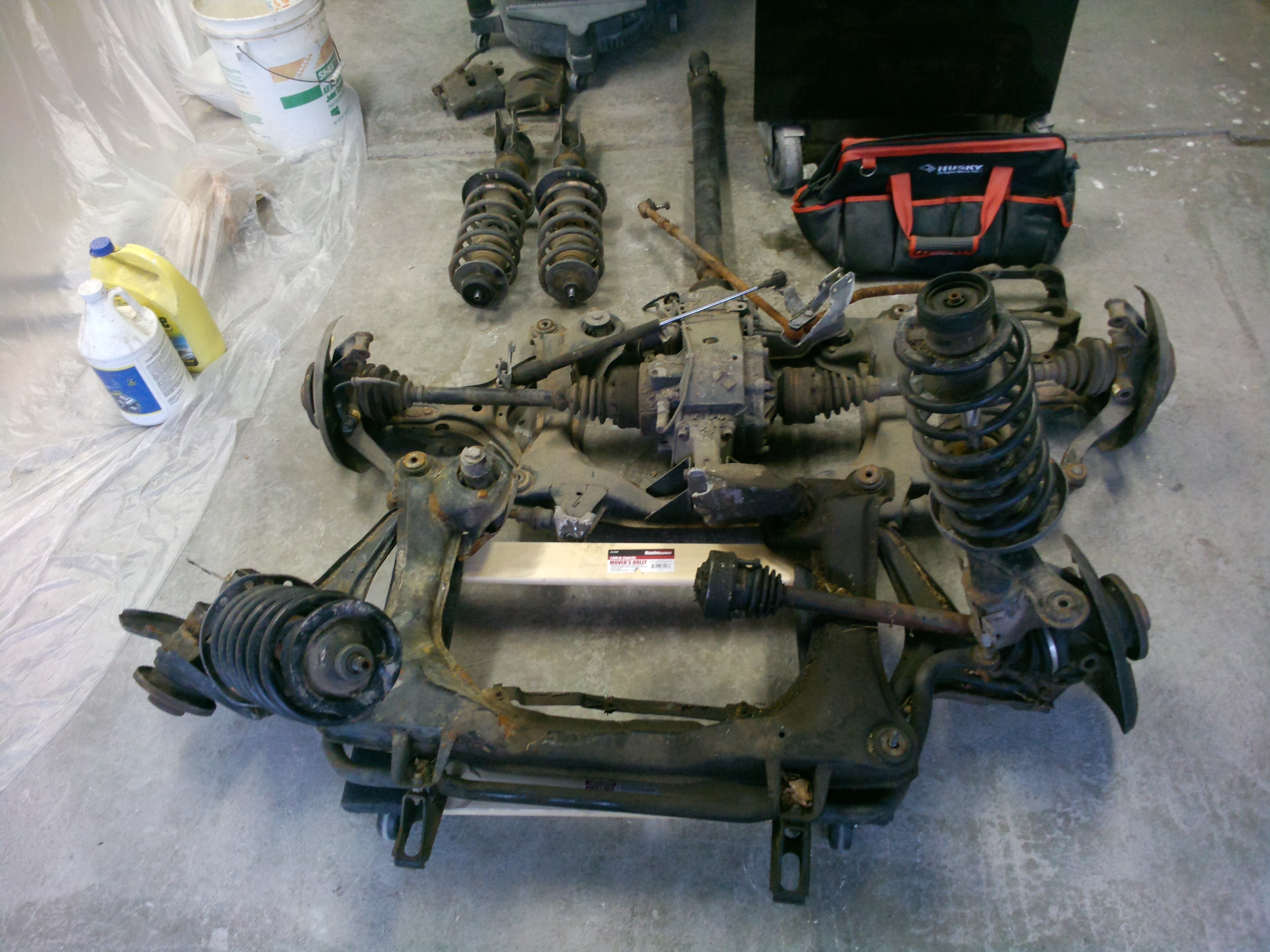

So yesterday I went up to help brent loose more of the totaled CQ at his shop. I came back with these, and the back hatch. I figured if these cars are getting more and more rare, it may be a good idea to have some extra glass thats hard to come by.
whats nice is that with the extra diff, I can install the torsen I've had sitting in storage for years and years without tearing my car apart.

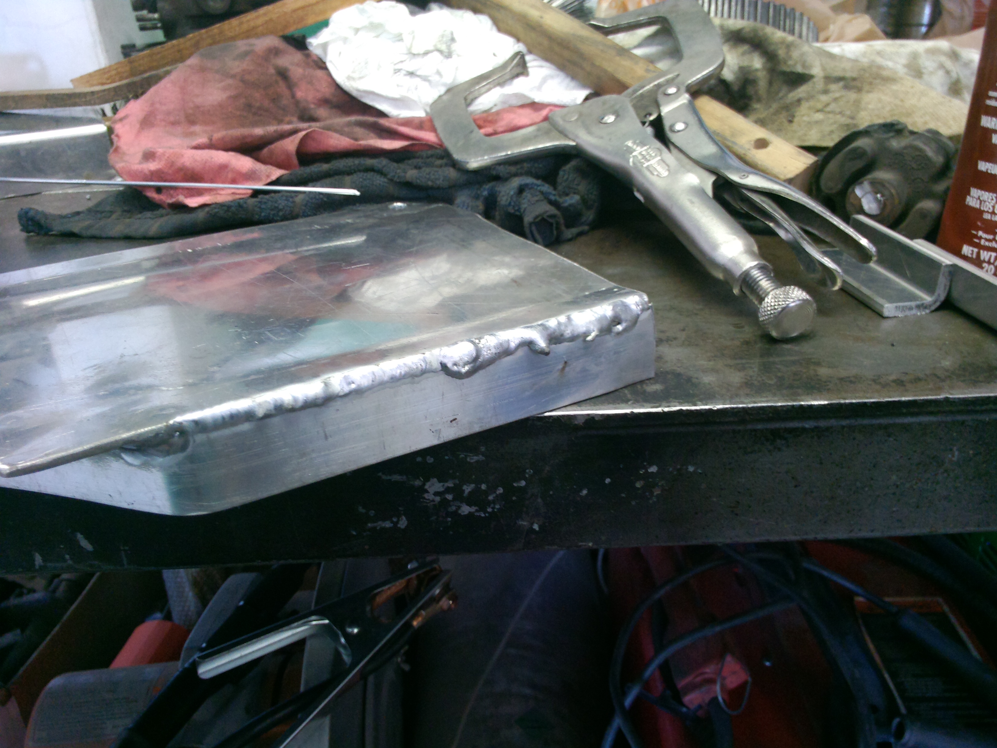

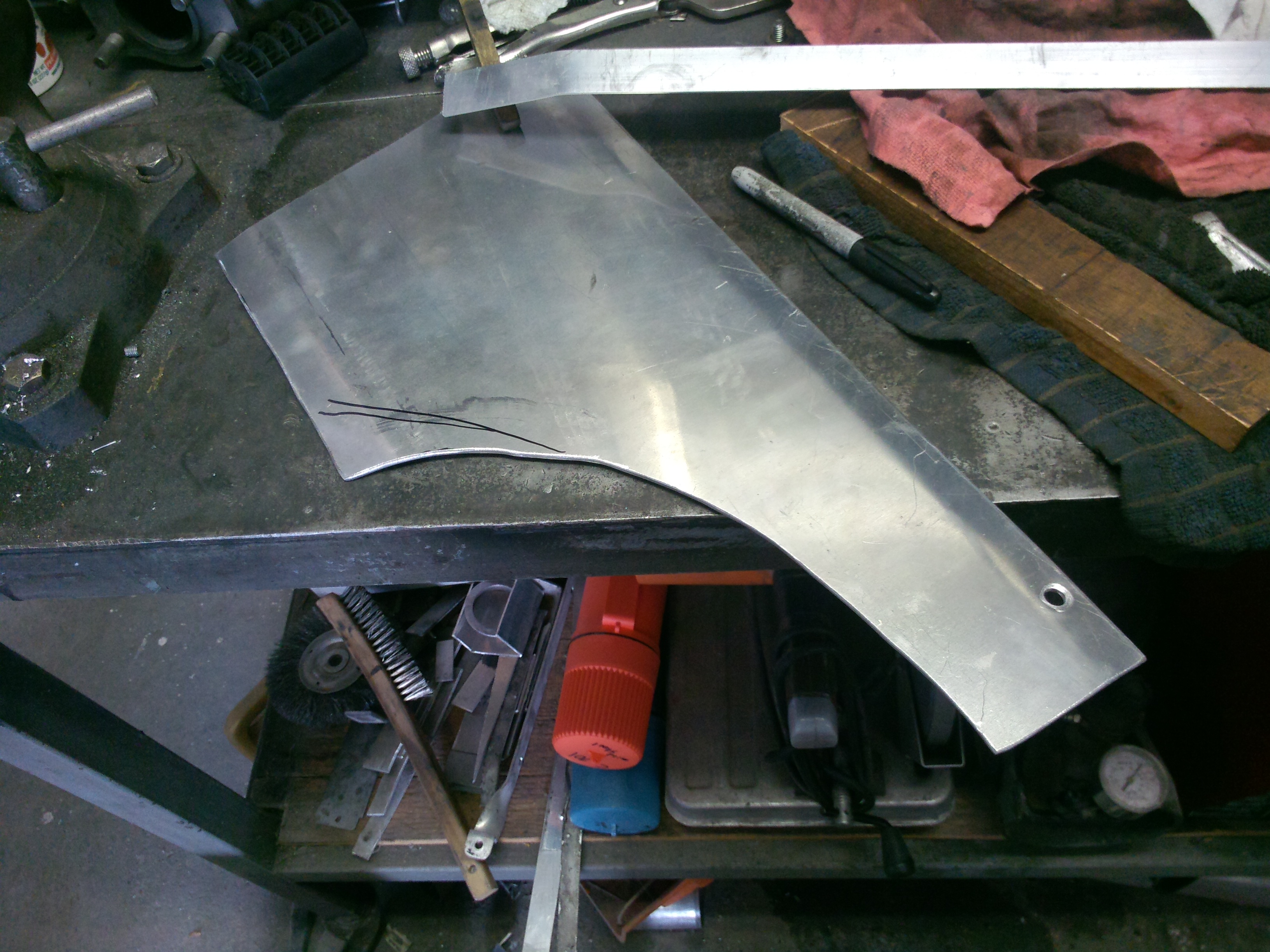

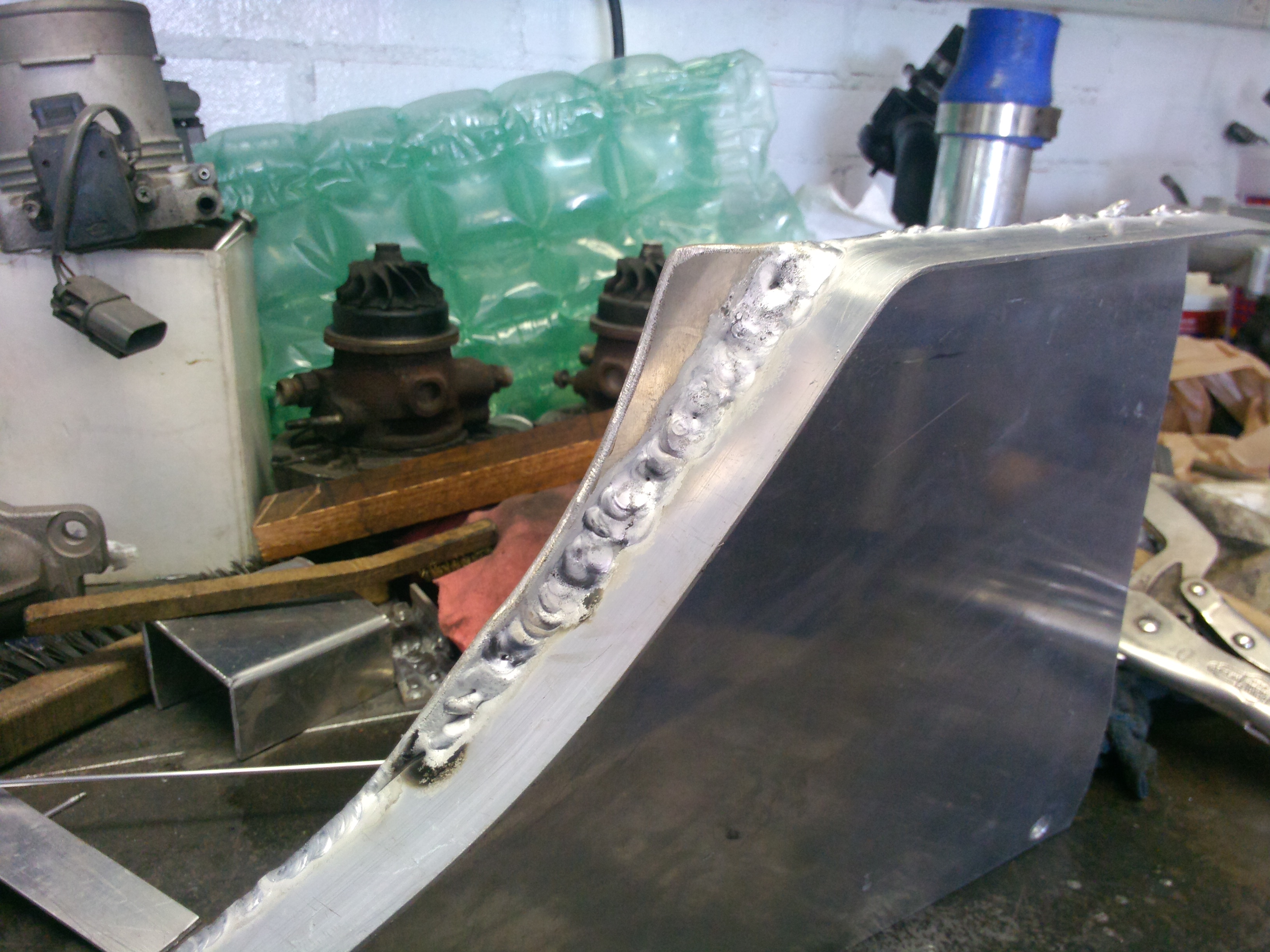

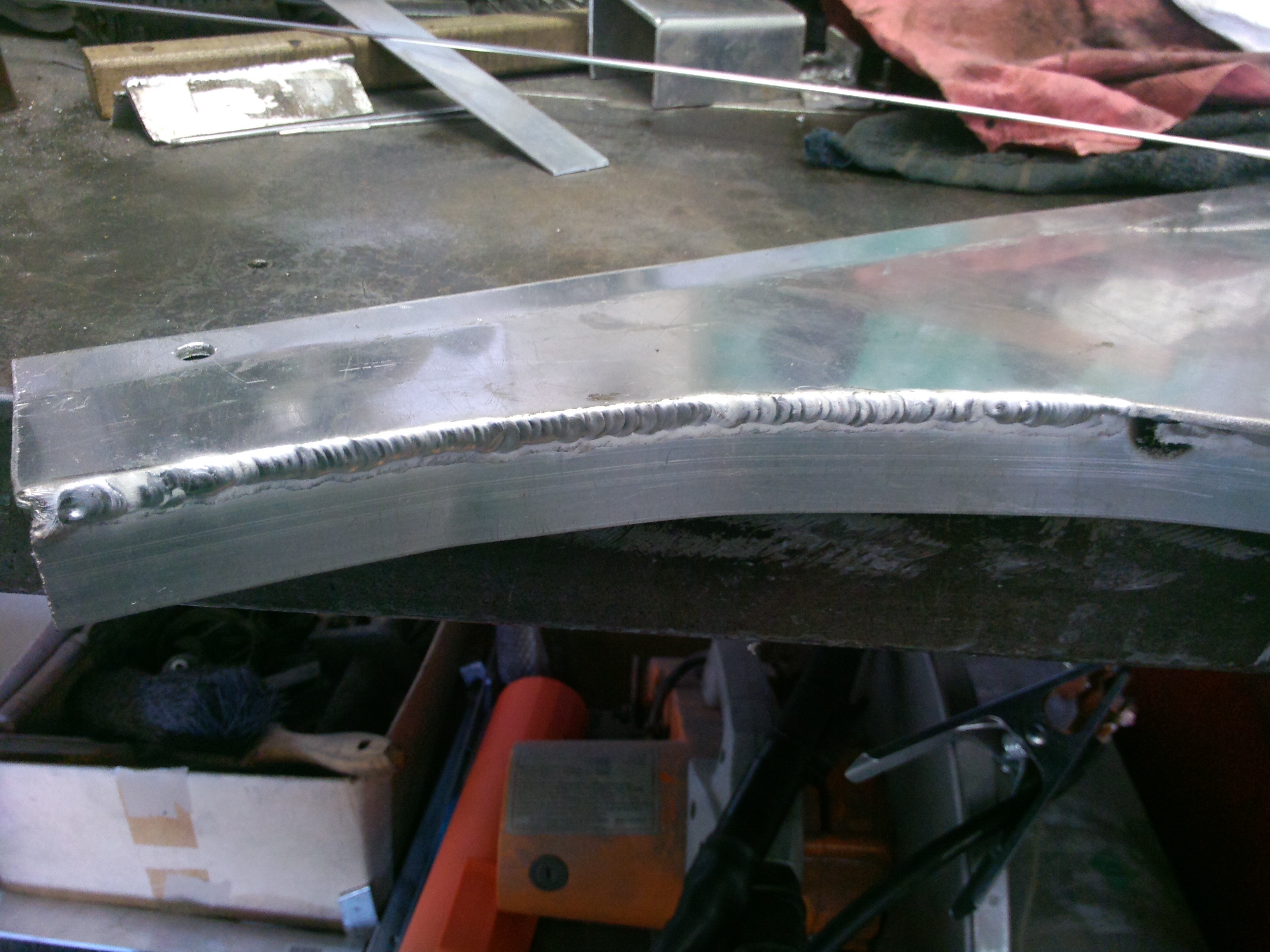

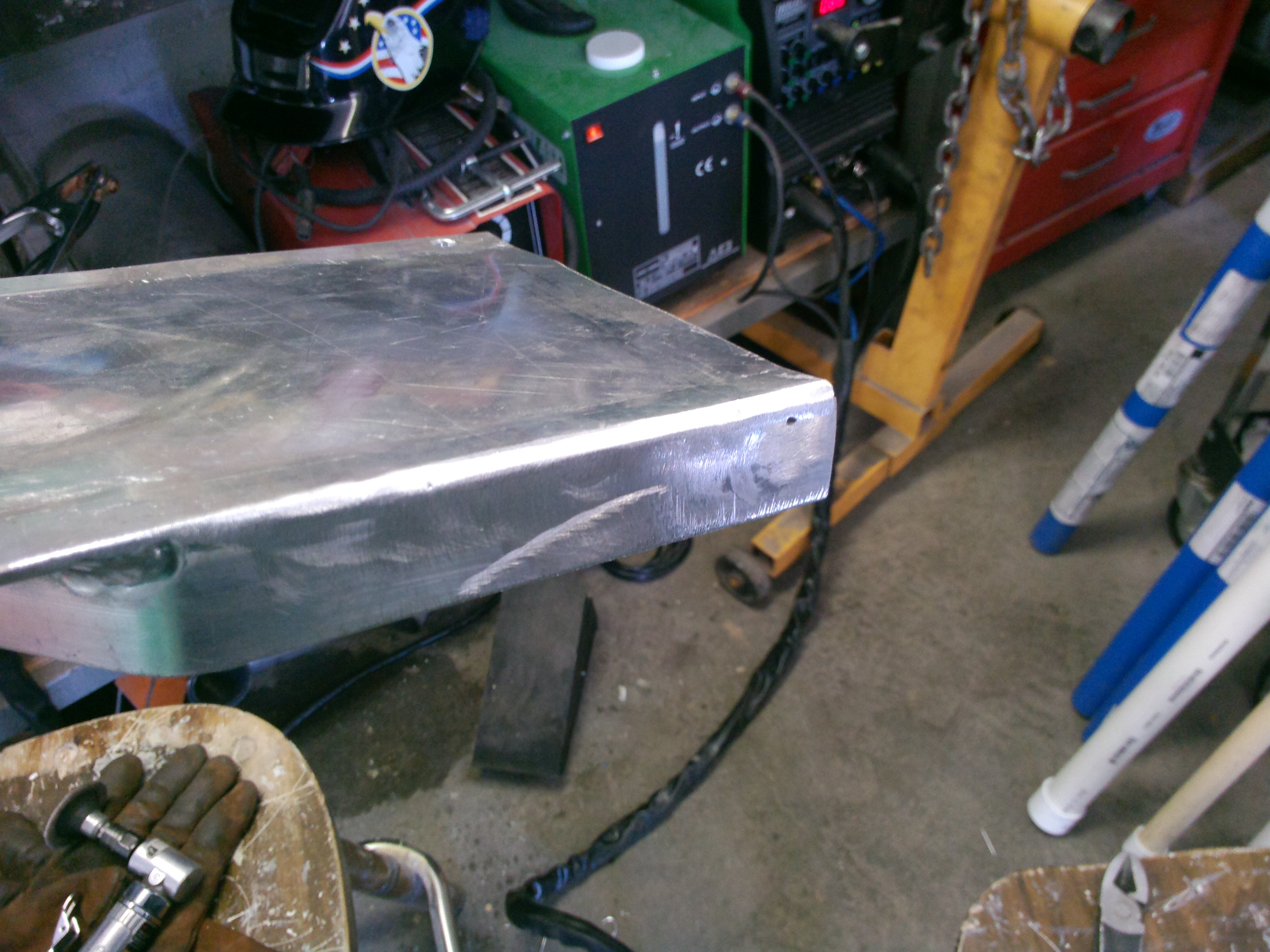

So yesterday I spent some time on the 90q as Im turning that into my DD and going to sell the V8Q asap. I noticed days ago that the coolant was disappearing for some reason, and being a tech, couldn't resist investigating. pressurising the system did not result in an answer, so while I was disassembling the suspension parts I got from brent, I let it idle. half an hour later, I had my answer. the rad was cracked down the front of the ds tank. I just happened to have a spare rad for that car when I was rummaging at a jy for parts for the coupe and the front mount rad endevour. Long story short, rad was replaced.
I missed my window to drop off the volvo turbo to the post office (sorry jared) because I was committed to finish the rad since the car was halfway in the garage and I was alone and not going to leave for half an hour while the garage door was open exposing all the garage innards. therefore, I decided to start playing with the tig and that aluminium panel I put up under the pass side dash. I wanted to weld a strip along the carpet, hiding the carpet edge and any exposed wires hanging out.
here is the patient.
Now, This is the first time I started to play with aluminium. I practiced first on some scrap pieces and couldnt quite figure it out and was unsure about the settings and technique. Gave Steve a call and he came up to help me understand it all. I got some initial instruction and got a bit better at the whole thing. Props to Hank and all those who build stuff for our obsession. Its not as easy as he makes it look. and Steve makes it look positively childish. Im not about to ruin that panel just yet, so I have some more practicing to do. When I do weld it, Ill get a pic so we can hang it on the fridge for all to see. I ain't skeerd.
Re: CQ project, the road less traveled ( on again, off again
Posted: Sun Sep 15, 2013 5:51 pm
by scubadave
K, I went and done did it. Its welded. I found that outside corners are easier than inside corners. by a lot. this part turned out good.
Inside corners and another part on the outside, not as much.
However, since I did that on the side thats not seen, it doesnt matter. I still need more practice, I know. Now, that outside goober weld, pretty much ok since Im better at removing metal. its all good.

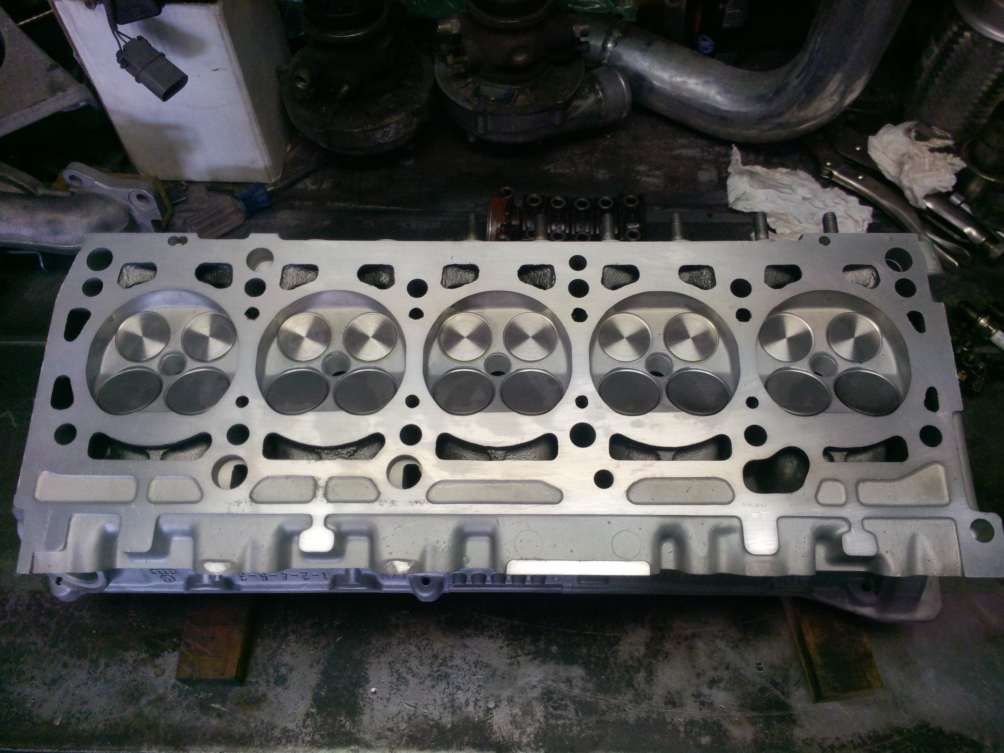

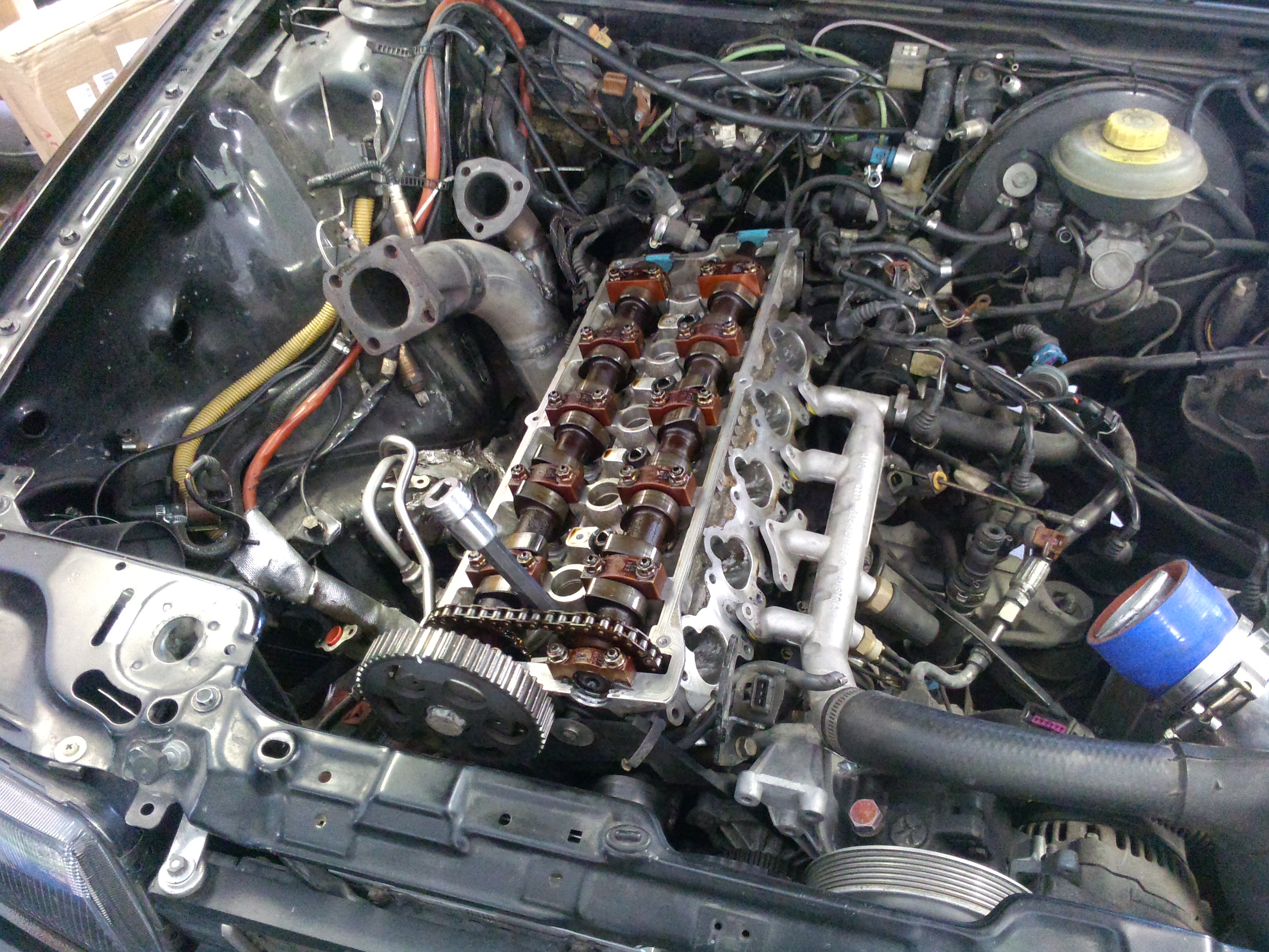

Got the head back a few days ago.
Also decided to replace my stock cams with my spare 7a cams. May as well get all the benefits if im building a motor capable of more than I'll ever use.

I took pics of the medium port job I did last time the head was off. I didn't have enough time to go to townon the head last time, and I have even less time this year. here is what I have done so far.
