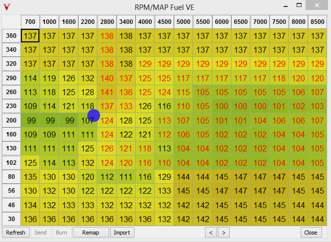

I took a look at your log. First I was looking at requested lambda and was like damn... that is spot on! I wouldn't change a thing! Then I realized my mistake LOL.
I gave it a quick first pass shot at tuning this a bit for you, but there is something wrong with my VEMStune so I can't save the config. I'm uploading a pic of the table if you want to input my values. I only tuned in the areas you made a pull in and smoothed it out around that a bit. I also took the rich hump out of the map by quite a bit (still no idea why my engine needed that).
If you do decide to use this, just make sure you monitor closely on the first pull. It's been a little while since I last tuned anything
It should be an improvement and I seriously doubt it is too far in the lean direction. I think you'll need to take more out if anything, but you never know.
- ben fuel tune.PNG (52.19 KiB) Viewed 32685 times
