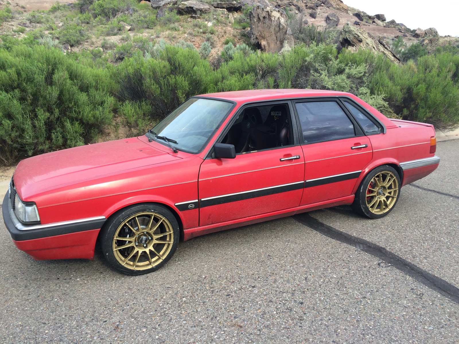

Posted: Thu May 28, 2015 11:24 pm
I can't not post this... There are quite a few important goodies Ross has been working on... We've been talking quite a bit lately :)
Re: 4 FOX SNAKES - Ross' 20vt 4kq
Posted: Fri May 29, 2015 4:46 am
Damn! Looks good!
So far I spy different wheels, Porsche brakes, and possibly different suspension.

by rossschnell
Yeah ok, seems like a good time to do an update. Its only been like 5 months.. I suck.
So Martin was right. The caster was all effed up after I incorrectly swapped housings (rt to left) on my 5lug swap/BBK upgrade. For some reason I wanted that darn caliper on the trailing side. Whatever. The car failed the first alignment and recorded -.3 degree caster, "Specified Range" is 0.9-1.9. Aside from it being a pain in the ass to rebuild and swap housings, it was kinda cool to experience the difference between proper and improper caster. A good lesson in steering geometry. Having negative caster actually made the car feel like I had power steering, bonus. It wasn't all that bad unless I was driving at highway speeds above 75mph, then it got a bit twitchy. Otherwise it was a dream to parking lot drive :)
Ok, so I fixed that and rebuilt it. I'll post up alignment specs later.
